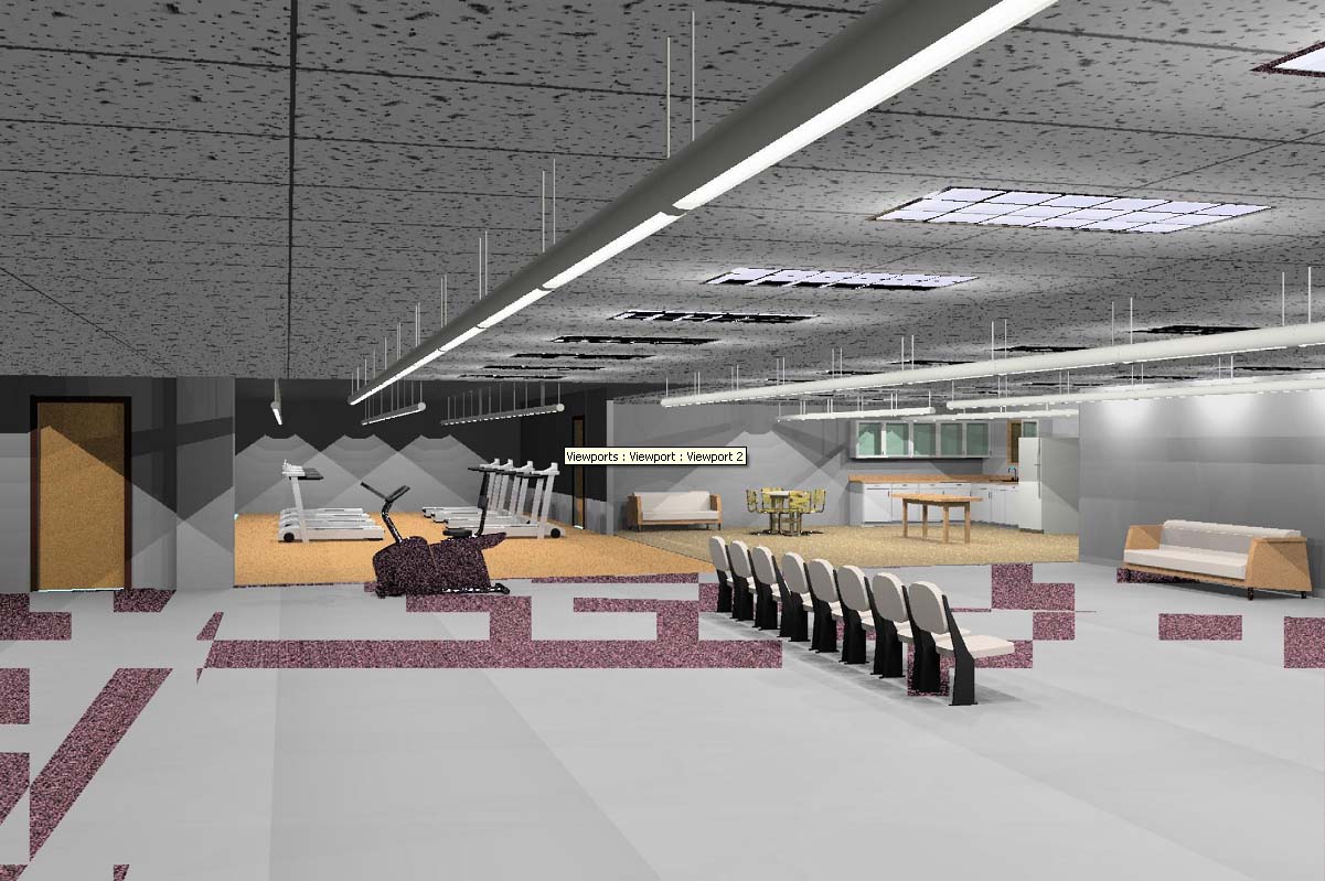

I am having issues with testing out render materials with objects as you can see in image below parts of objects will not render completely.  Do you think it has more to do with type of material and its settings or rendering engine error or computers memory and capabilities?? Any help would be greatly appreciated!!

This would be a hardware problem.  To confirm this, try and render a smaller area using the region in the render dialogue box.  You can also try zooming out a bit before rendering, which makes the rendering smaller.
What hardware spec do you have and what version of Revit are you using?
