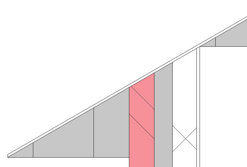

Hi there Revit city people.
The problem is that when I set the width of pitched roof to be 10mm and attached the walls below, I can see in elevation, 3D and site plan traces of those walls and when I print the drawing in certain scale I  see the lines on the plot?
I am working on REVIT 2009
Nirim

If you draw a section does it look like this, or does the wall extend to the top of the layer?
Mon, May 18, 2009 at 3:03:38 AM | Roof width
nirim
Joined: Tue, Dec 19, 2006
140 Posts
5 Stars: 12 Votes
 Hi tim1234
I hope you still there (I mean after the weekend), Yes the wall extend to the top of the layer.

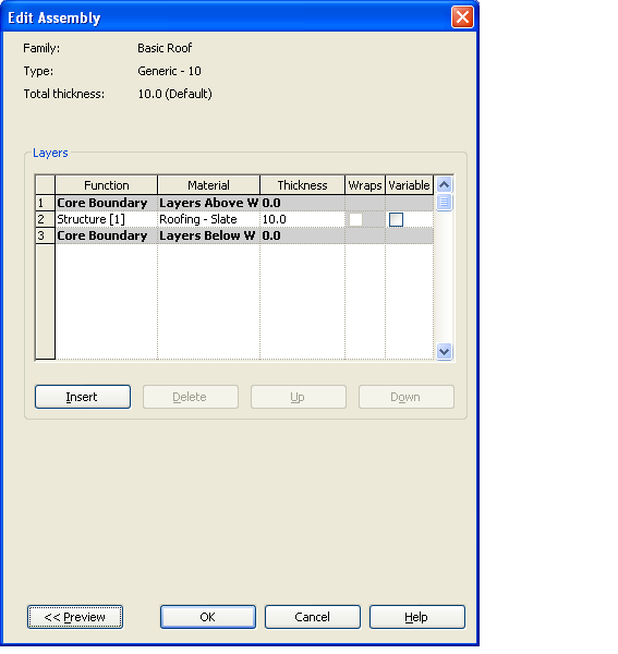

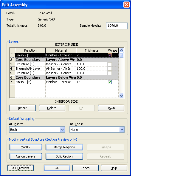

Mon, May 18, 2009 at 6:00:57 AM | Roof width
nirim
140 Posts
5 Stars: 12 Votes
Hi tim123
If you still have energy for that? Have a look at the attached files showing the problem and the construction of the wall and the roof. I think the priority is ok but still have problem.

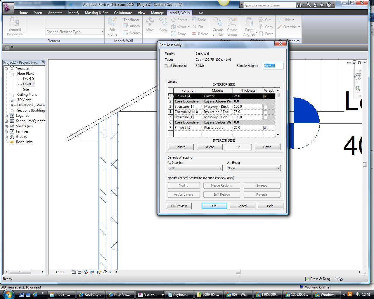

Mon, May 18, 2009 at 6:57:10 AM | Roof width
tim123
Joined: Tue, Apr 12, 2005
1310 Posts
4 Stars: 19 Votes
I gave creaeted a similar setup to what you have, the roof is also similar.  This seems to work.  I do notice that when I zoom out I can see the wall lines through the thin roof, but these do not print and dissappear when I zoom in closer.

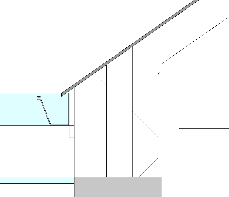

cut a section like tim did and post that
Mon, May 18, 2009 at 9:45:52 AM | Roof width
#13
nirim
140 Posts
5 Stars: 12 Votes
Attached the image.
nirim

The roof looks fine - the only thing that I can think of is a view is set to wire frame, or the roof material has some transparancy.
