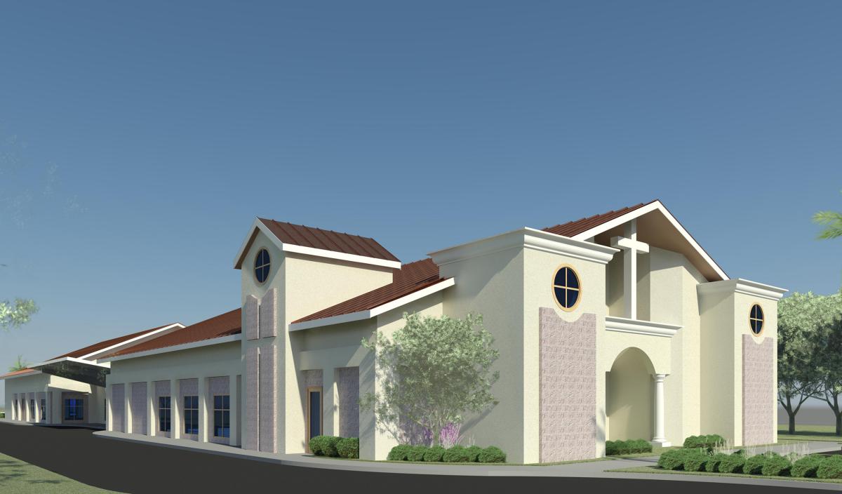

nice church- perfect revit rendering..

great render,how did you create that rib type roofing.? thanks.

I created a normal roof then made a copy above and changed that roof to a sloped glazing type. Then took the profile of a standing seam roof and inserted into file as a profile.  Next you will create a new curtain wall mullion type and set the profile as your standing seam profile.  Adjust your mullion spacing so it has an equal distance to the over width of your roof panel. Then just move it on top of the original roof. Make sense?
