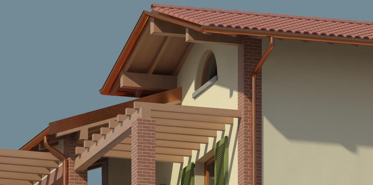

I can almost picture this house somewhere on a mediterranean shore overlooking a village. I like it. Please share how you achive the barrel tiles roof.
Thank You!

Please tell me it is not an array!

arcline360..I can almost picture this house somewhere on a mediterranean shore overlooking a village. I like it. Please share how you achive the barrel tiles roof.
Thank You!
User Menu2128bpounds   Please tell me it is not an array!
hello guys..its just a simple as family...go to family..pick the furniture system...and make a roof design you want...(remember the degres of the roof)...and load into project...then copy the roof that you make..thats it... hope it helps...

I create that with "Sloped Glazing" system.... very simple, see my gallery images....
