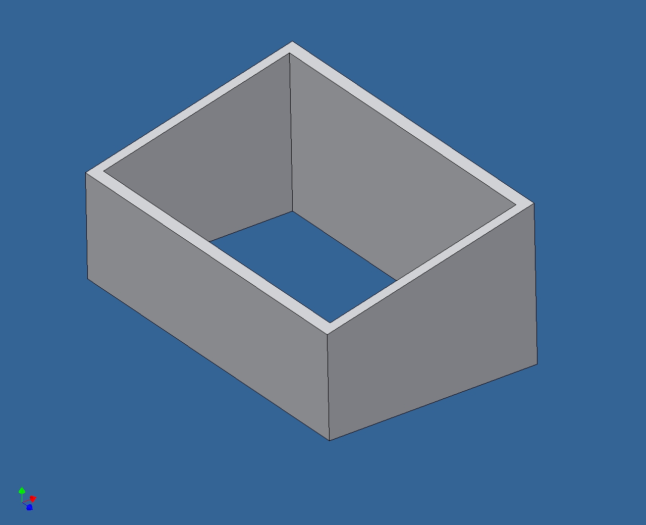

I have been useing Inventor to do my building models. Now I am slogging through another series of tutorials, but I have a project that has a time clock ticking and although i can build a six floor retail building I can't seem to build a simple one floor house that looks like a lean-to. I can't figyre out how to make the side walls angled to join the front and back walls. I'll bet I can't see the forest for the trees.......

Not sure this is what you're looking for, but maybe it is?
You can create walls at all sorts of slopes and shapes if you start with the "mass" shapes and then use the "wall by face command".  Is the attached example what you mean by "angled walls"?

If you wanted the entire wall to lean, then go with what Dano had to say.  If you already have thoes walls and are trying to cant the end of the 2 other walls then edit the profile of the walls and just change where the lines are to cut your wall at the angle that you want it.

Thank you so much for giving your time to help me. When I have this worked out I promise to pay it forward. I have attached a .jpeg screen shot from Inventor of the walls....
