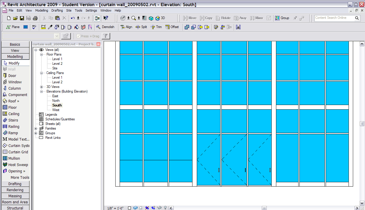

Sun, May 3, 2009 at 7:16:09 PM | Curtain wall doors
fixybopixy
Joined: Mon, Mar 9, 2009
39 Posts
ok so i am designing my own curtain grid system. I am placing doors into the curtain wall as "curtain wall single glass." You can see three of them in the middle of this curtain wall. However, notice they all face the same way and open the same way. I want to change the orientation so that it looks like 1 set of double doors and then a third door next to it. how can i do this?
 see attached. thanks!
Mon, May 4, 2009 at 2:05:34 AM | Curtain wall doors
tim123
Joined: Tue, Apr 12, 2005
1310 Posts
4 Stars: 19 Votes
You can flip them in a plan view as you can do with normal doors.
