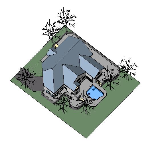

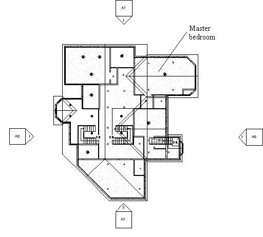

heres a couple of images of a house im doing for a comp. the two roof end up in a valley, and that of course would cause some major issues with water flow. i wanted to know how i could fix this, thanks.
also the projects due friday.
My Futurama Fan Fiction 'Hammer087' - http://futurama-madhouse.com.ar/fanfic/indexh.shtml#hammer087
Wed, May 2, 2007 at 9:28:05 AM | roof help
Not a good situation.   Not only do you have potential water problems but basically, the whole back side of your main roof has to be picked up by beams or girders.
Can you step the center ridge of your main roof back so the back eave lines up with the wall between the stairs & great room.  That would improve your structure and roof conditions.

can you explian by that, btw the room below the is the master bedroom. what i thought of was taking the back side of the main roof and pulling it out so that the other two dont form a valley

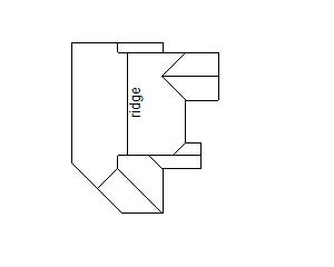

Wed, May 2, 2007 at 10:32:38 AM | roof help
Something like attached might work

Wed, May 2, 2007 at 11:29:58 AM | roof help
Sorry - I don't understand the question.
You have a main roof with staggered ridge running top to bottom with on the right side a standard eave. At the bottom end of this main roof you have the truncated hip that you originally showed.  ( This gives you a funky roof edge over what I assume is the entry area at the lower left corner. - This might be better handled if you turned the main ridge to be perpindicular to this angled wall but your the designer.)   On the right side, you have two gables.  ( Which are not shown as hipped on my sketch.)
Wed, May 2, 2007 at 11:37:54 AM | roof help
framerman
Joined: Tue, Jun 29, 2004
543 Posts
4 Stars: 13 Votes
What we've done in the field sometimes is a large cricket. Not the greatest of solutions, but it works.

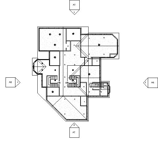

Thu, May 3, 2007 at 9:19:07 AM | roof help
hammer87
hammer87 Avatar
Joined: Tue, Oct 25, 2005
310 Posts
3 Stars: 4 Votes
i see what i manged to solve the problem. what i did was take the back side of the main roof and alinged it with the the wall the goes the two sides. then made sperate roofs over the reaming areas and joined the roofs.

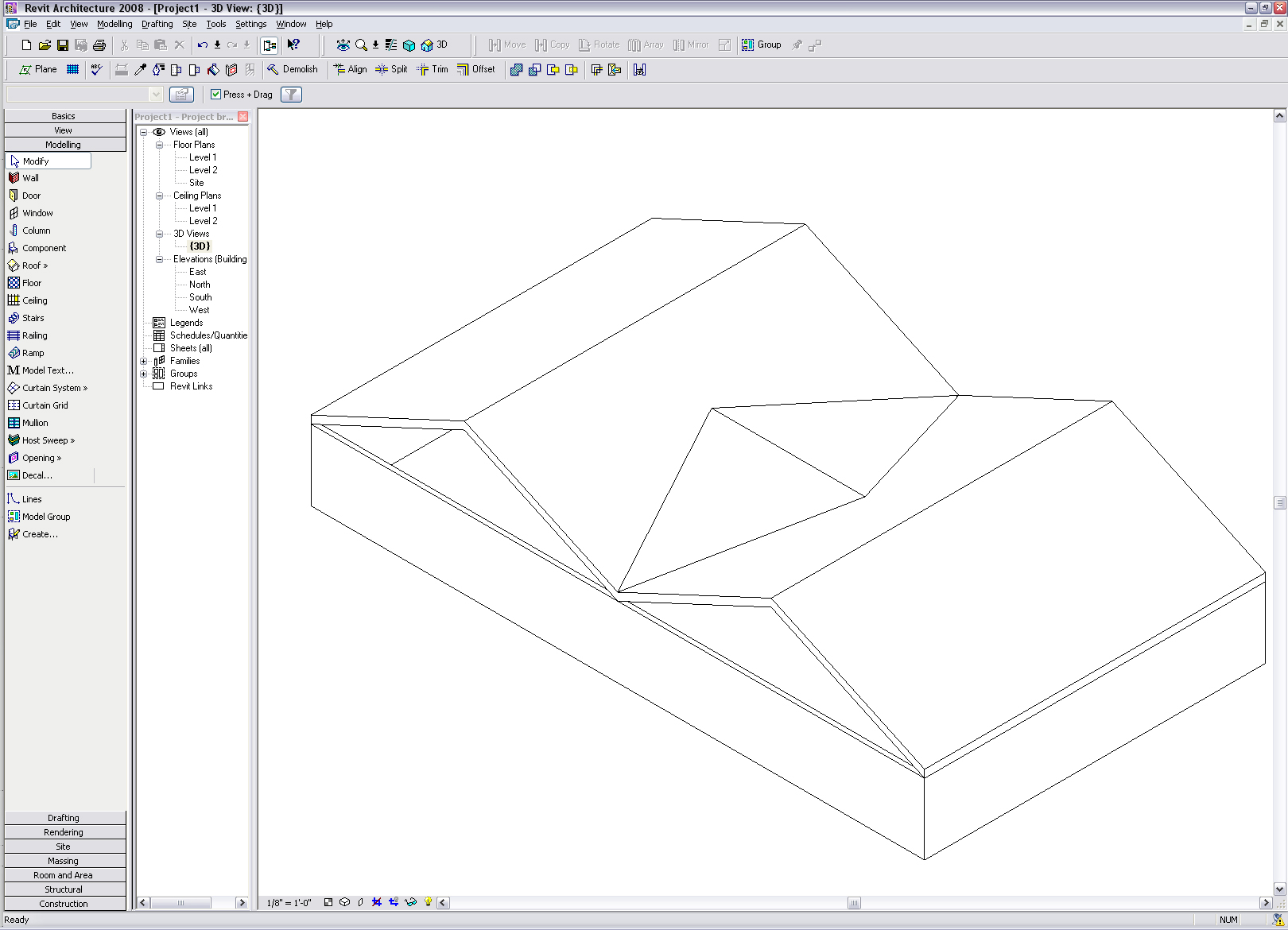

Wed, Feb 5, 2014 at 7:19:21 PM | roof help
#9
huskyrna
Joined: Wed, Feb 5, 2014
0 Posts
nice job!
do you know how i can create rectangular base but no gable -pyramid hip roof?
Thu, Feb 6, 2014 at 7:27:07 AM | roof help
#10
teafoe5
teafoe5 Avatar
Joined: Fri, Nov 12, 2010
1749 Posts
4 Stars: 47 Votes
These posts are over 7 years old, you should have created a new thread for any questions. However to answer your question you would just put a slope on all 4 sides of your building, same slope all the way around if your building is square.
