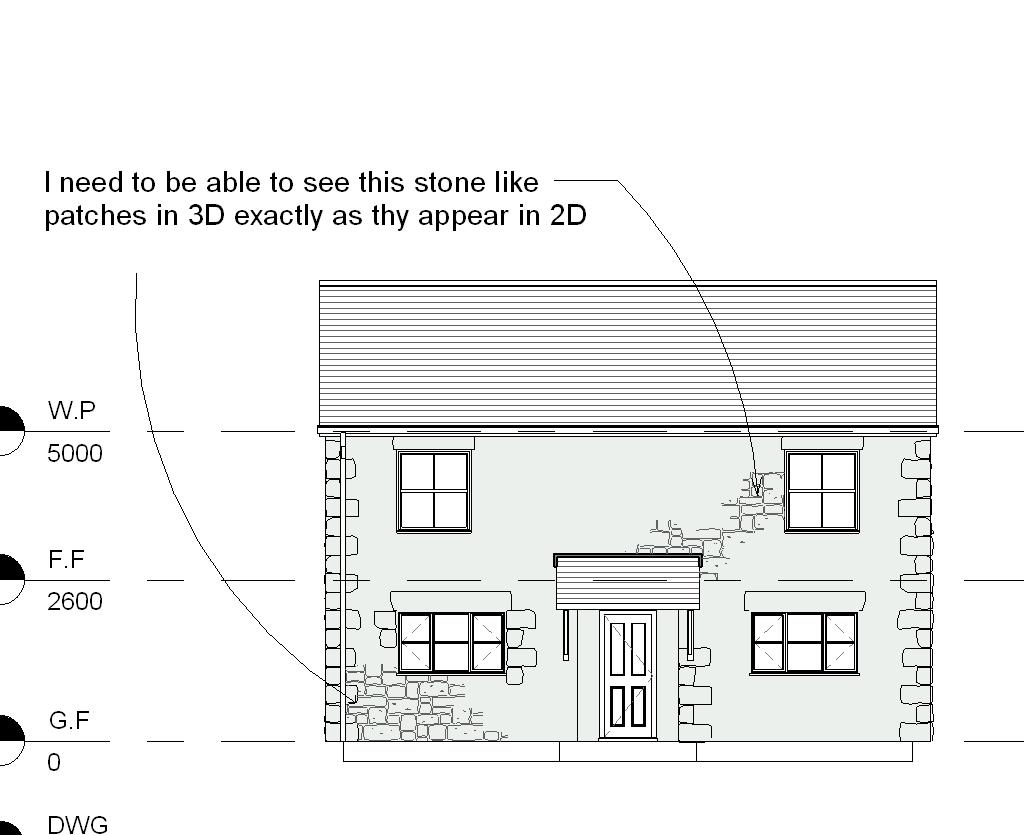

Sorry for the dely in my replay , I wasn’t at the office. the thing that I want to achieve is to be dale to see the hatch pattern on both elevation and in 3D model.

I understand all of the above but as I wrote to WWHud what I need is to be able to see both in 2D and 3D the  stone patch like effect on the surface of the wall and not the entire wall cover by stone like pattern , see attach  file.

Sorry to bother you all but I think I find a solution: I chose cobble like pattern for the wall finish material and then mask part of the wall surface and the quoins.

Well it would've been a lot easier for us to help if you had've posted that image to begin with...
As you can see by your responses nobody knew that was what you were after.
To achieve what you want your only real options are to:
A.  Create a hatch pattern that is already 'patchy' like that.
B.  Use the split face tool to break up the wall into different sections and apply different materials to each section ie: with and without hatch patterns.
C.  Use model lines with the wall face set as the work plane and draw the patterns on.
D.  As i think you suggested, create another thin wall in front to conceal the hatch in the unwanted sections...
