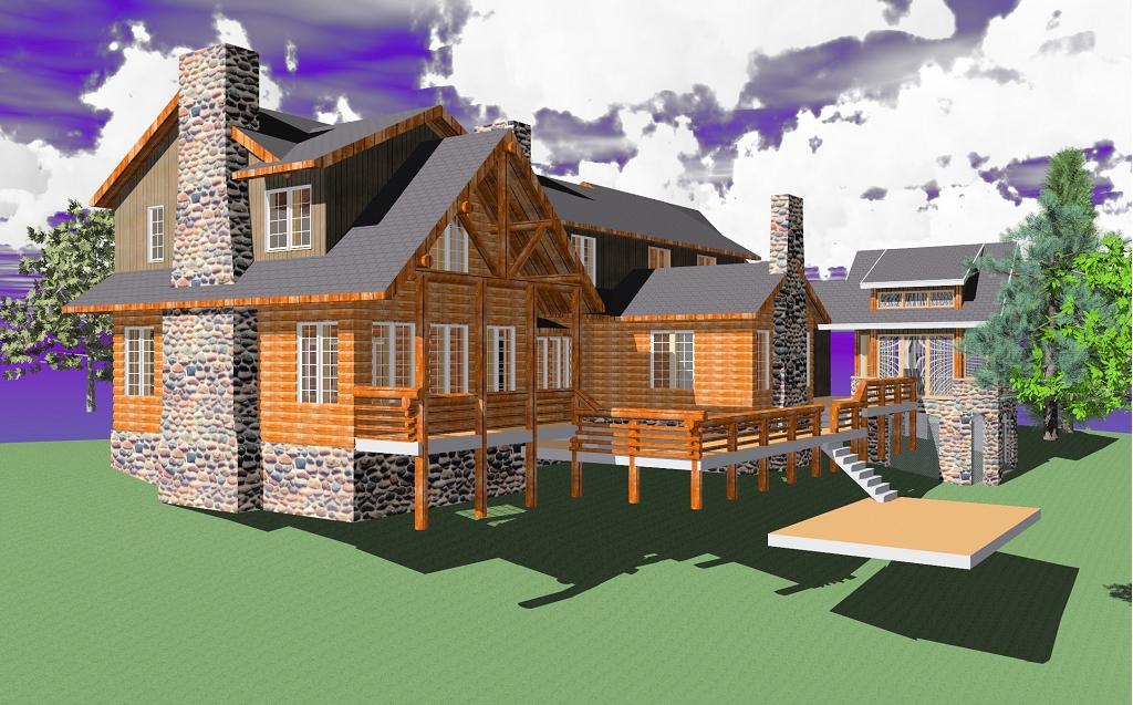

Take a look here: http://www.edgewoodlog.com/inmedia/index.html The house featured in the top 10 2007 Annual Buyers Guide (Third plan down) gives you somewhat an idea of this.  It was done in ArchiCAD and I did some of the preliminary design work on it when I worked there.  It used to be allot bigger!

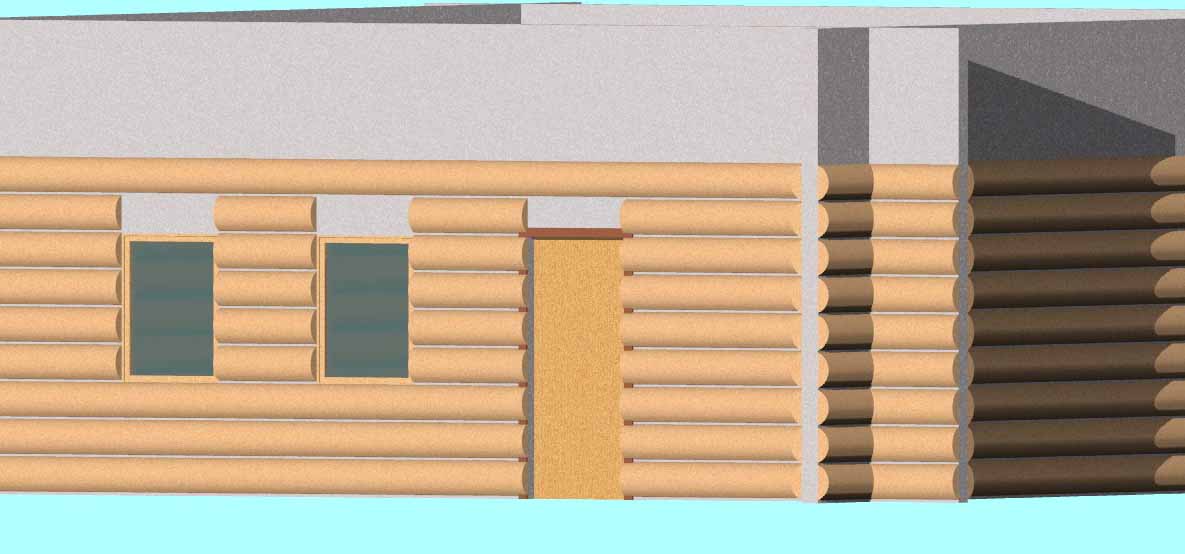

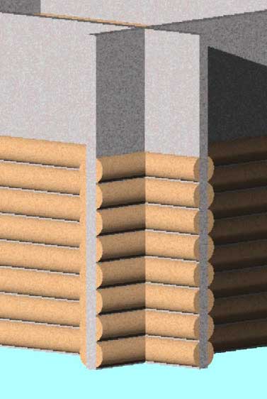

Here is my attempt using host sweeps.. I used a concrete wall for the chink effect....but then it causes issues for the ends...  I am thinking I may have to use some-sort of family object instead.

Same attempt - add door and windows.... lost a log course above the windows though....
 Cryingedit: Just realized I would need two different types of walls.....so that I can get the proper stack effect)
