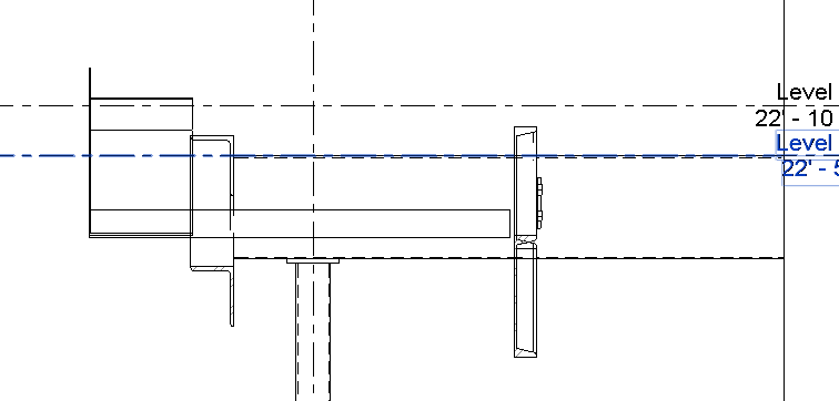

Still trying to figure out sections in Revit versus our old autocad ways. Typically, we might show something in the foreground and something slightly in the background with any sloping framing in between in cross-section. In Revit, I have to move my depth of view out to encompass both objects (i.e. a purlin near the ridge and a beam actually at the ridge), which makes the edge angle that's sloping down across the purlins show up as an extruded section that isn't as easy to discern as it was in the ACAD sections that just showed it as a plane section. Is there any way to show a near zero depth section view so that sloped framing is still clear as a cross-section, but with background objects (i.e. a few inches away) stil showing up in the section? Hopefully the ACAD section and my current Revit attempt that are attached will help explain what I'm after. Thanks again!
Mon, Oct 3, 2011 at 9:56:55 AM | Section problems
Sometimes it is best to add a detail element and turn off the model element.  Or sometimes, you can just use the linework tool to turn off lines that obfuscate the detail....
