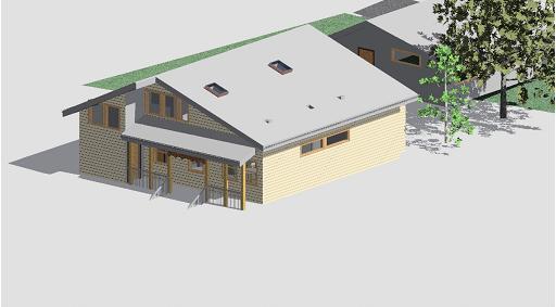

Where can I reset the Ground Plane when rendering a 3D model? At present it cuts off part of my topo surface so I'm assuming it is the ground plane that does so.

Look at SETTINGS menu, SUN AND SHADOW ... uncheck Ground plane

Thanks. I was looking in the rendering section.
