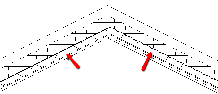

Is it possible to align pattern to 2 different referance points in the same element. In a roof section I want ridgid insulation to be alignd with the roof and I can get it to work with one side but not the other (and I dont really want to break the roof in the middle so that it would).
See attached photo. The right side is correct but the left is all weird and I don't like it.
Not sure if what I want is currenly possible.
Revit 2020
Thanks!

Afaik, it's not possible. You can use vertical or horizontal lines cut pattern - at least both sides will be the same, or use filled region for the side that you don't like.
