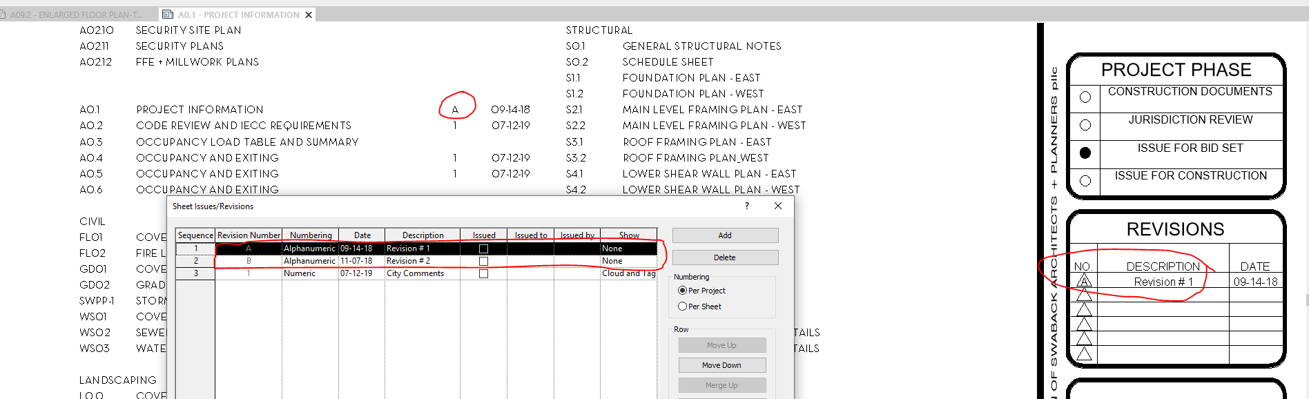

It was brought to my attention that we have 3 revisions in this project. The first two revisions i.e. ‘A’ & ‘B’ are set to show NONE for the the revision cloud and tag. And yet they are showing in the revision schedule and on the sheet. last we these were the same settings and we did not have a problem. Attached is a screen shot of what I am talking about

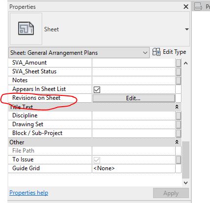

'Show None' means that the revision cloud and it't tag do not show.  It should still appear in the revisions though.  Note that you can associate revisions directly to a sheet - perhaps this has happened.
