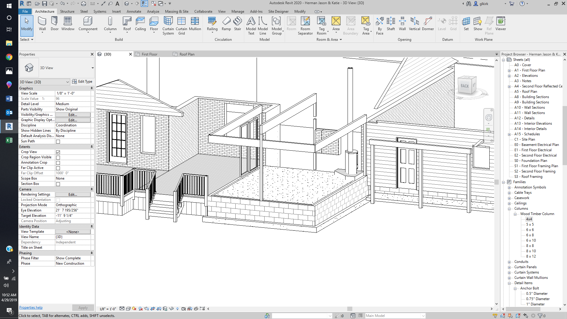

There are 4x4 columns at the outside corners of this porch but they are not showing.
The column at the rear has a space cut out of it.
Can anyone enlighten me why this is happening?

Probably just tured off in VG.

Thanks, but , so far, all I have found is that if the column in in a wall, then the program will not let it show, even if the wall is hidden,
The only way I have found to make them show, so far, is to delete the wall.
 Does anyone have any thoughts on that?

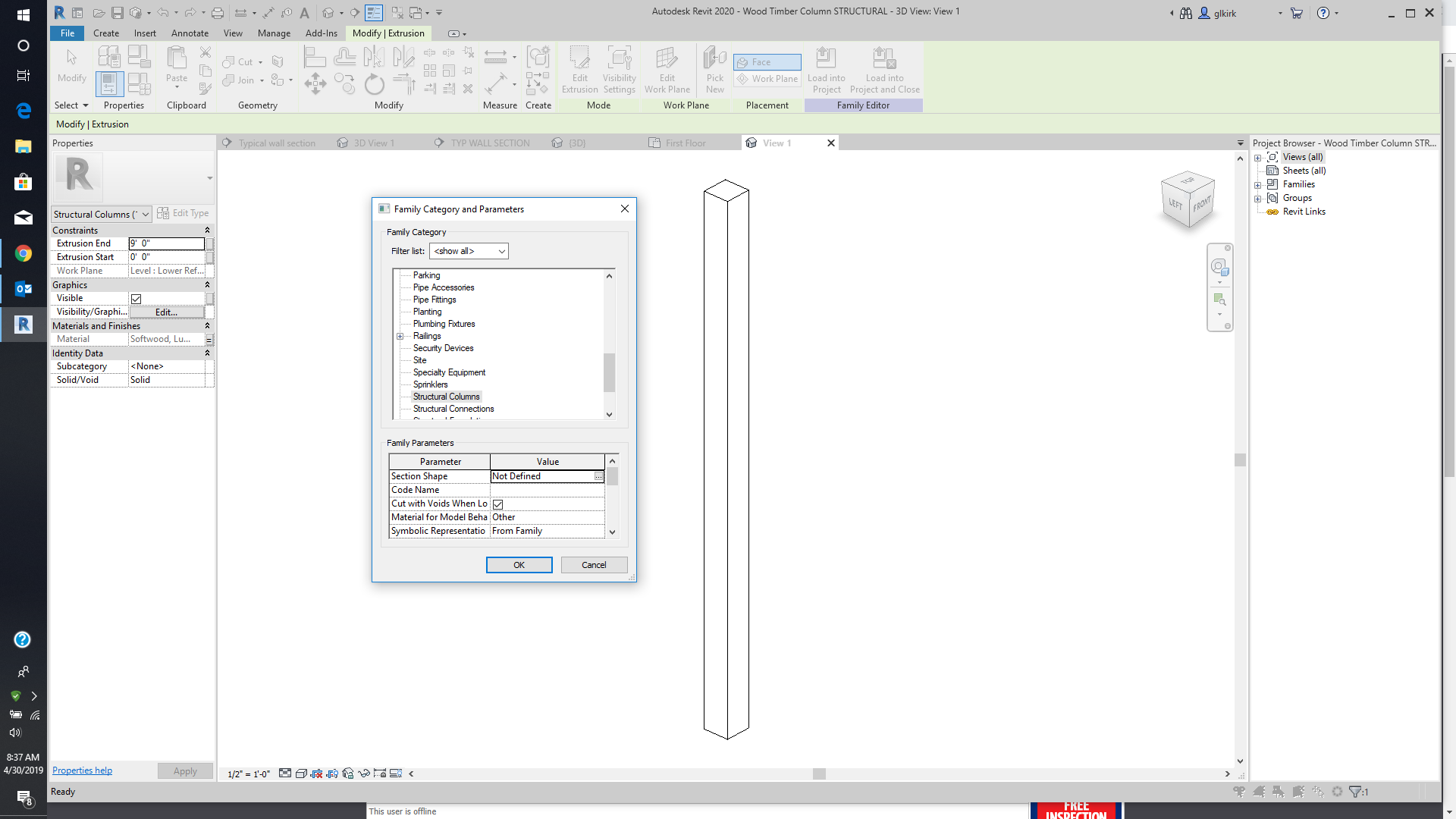

Use a structural column.  The Architectural columns blend with the walls.
You can open the column in the family editor and change it's category to Structural.

I think I set it to strucural but no change.
