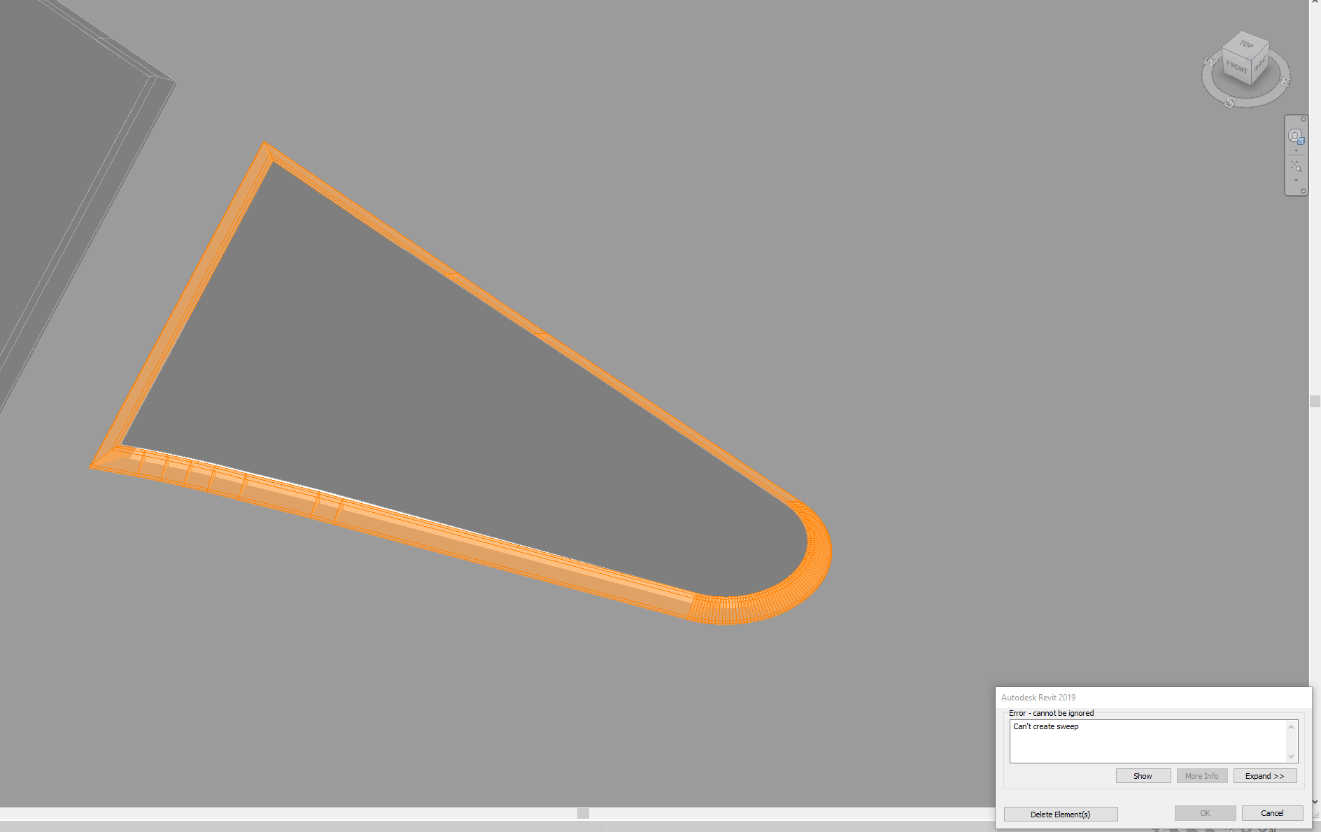

I am currently trying to sweep a kerb on a road I have made on a topography. I am recieving an error issue whenever I try to close the sweep. It works fine, providing I don't close it. Is there any way to fix this?

You have a couple of tight corners in this sweep.  Profiles will not work if they can't turn this tight corner.  Examine your profile family and experiment with where the profile is in relation to the y axis.  Experiment and you will learn what is going wrong.

Also check that your path is on the inside of the curve - this allows for tighter radii.
