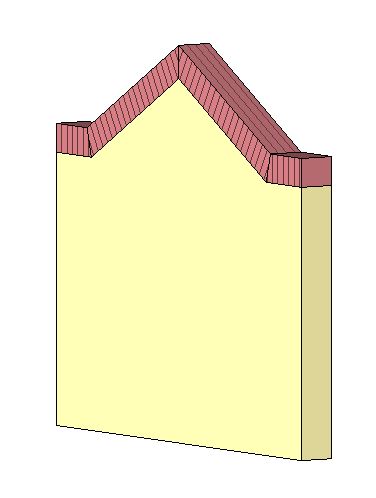

The post that WWHub refers to does show 3D methods.  An alternative is to create a roof by extrusion that is the shape of the gable, and the depth of the wall, with the thickness equal to the brick height.  The wall can then attach to it.  I have split the face of the coping so that I could align the soldier course brick pattern here.
