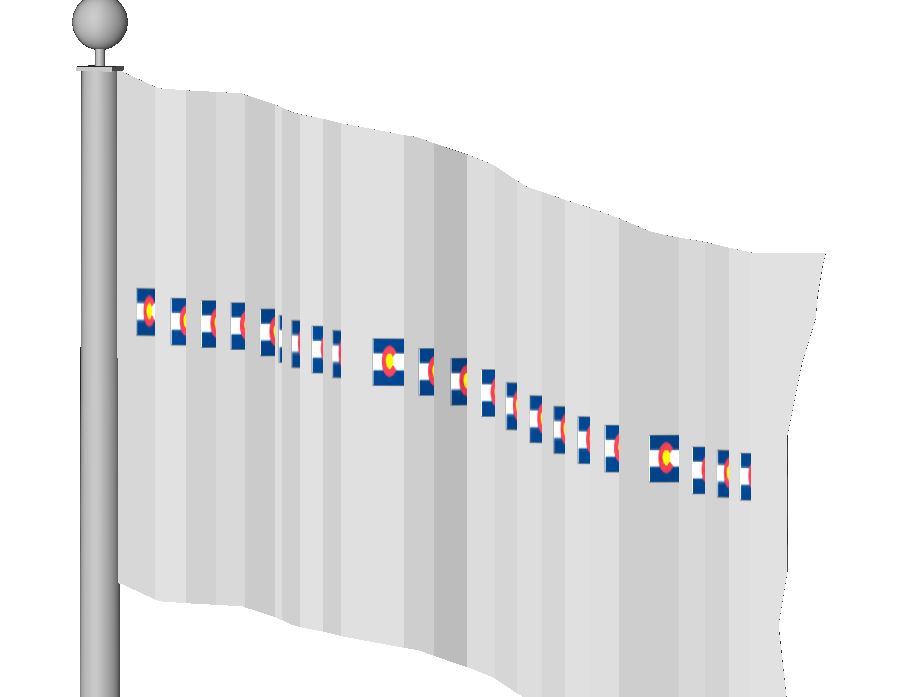

Does anyone have a Colorado flag with flagpole?  Or perhaps create one?  I have tried numerous methods for applying a materials image without tiling to no avail.  I just need a seamless image on a flag.  HELP!

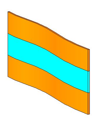

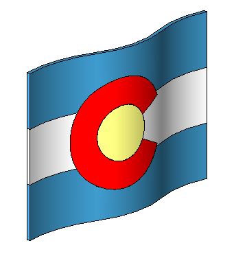

If you have to do it in Revit an option is to extrude the different colours and then cut out the flag shape with a void.  It's not ideal as the shapes will still be flat, which will distort it, but this will probably not be very noticeable.
