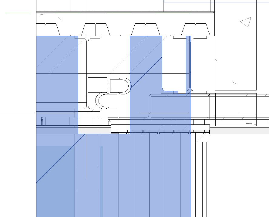

I am trying to schedule some generic window shade family per room. Problem is my room has two large gaps at the top that are very specific looking, however I cannot find what is causing them. The window shades happen ot be within the gap so I cannot schedule them to the room- I think its coincidental. I've checked all worksets and phases and there's nothing there. I've turned all horizontal room bounding elements off. It's driving me crazy, has anyone come across this before? Photo attached.

Look at the room bounding elemts on the floor above - they may be extending inot the spaces below.

No, I've deleted the room, deleted everything above and below it and when I put the room back in it still has these holes cut out of it. Design options can't control room boundaries as far as I know so I'm really at a loss.
Fri, Oct 12, 2018 at 11:54:09 AM | Specific Looking Holes in Sectional Room Boundary
If you are using design options, they can control room boundry if the option is active but I'm not sure that is your problem.
Have you got all of your worksets on in this view?
Are you using phases?
The shape of these do not look like rooms but they could be.  They could also be any other type of room bounding element.  Some room bounding elements are listed here in your HELP.

So I checked all the phases and work sets and finally found one of the culprets. Someone had drawn an empty curtain panel soffit that had been turned on as room bounding. I never found what was causing the other gap/ hole but I can now schedule the shades so I'm just going to leave it as is.
