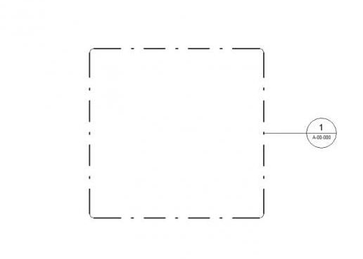

Hi guys, i need a help..
Need dummy callout...with option for adding sheet name and view number.
Please help asap..
Thanks

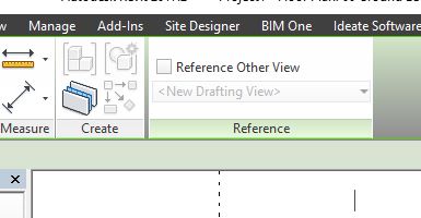

Try the "Reference Other View" and then refer it to the view that you would like.

I dont want to give reffrence other view option ..as my detail sheets are preparing in cad...just need a dummy callout to show

found a file in 2019..but i dont have 2019 version..can anyone make same thing in 2017 and send it to me..i got a submission today..it will be a big help if anyone can do it for me.. TIA
