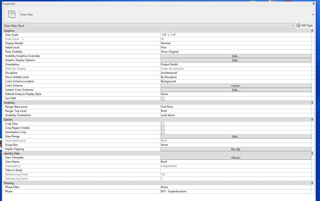

Revit 2017 - I took it from level 1 where I created a floor plan. The created a roof - it prompted to create on roof level. I said yes and then
the floor plan went ghosted and I used it to create the roof. It shows in 2d, elevations and section but does not show on the roof plan. What am I doing wrong. Any help will be appreciated. I havef read all the roof threads to see if I could figure it out but can.t - Thank you Byron

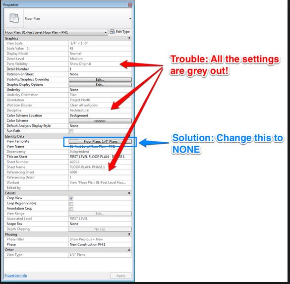

Try adjusting your view range - its not high enough to see the roof.

The view range button is ghosted and cannot change anything
Mon, Jul 16, 2018 at 3:39:09 PM | Roof Help
Does your view have a view template?  Turn that off.

Show us an image of your view properties similar to attached but large enough that we can read it.
Mon, Jul 16, 2018 at 7:20:11 PM | Roof Help
1bchristian
Joined: Sun, Apr 22, 2018
0 Posts
Here you go
Tue, Jul 17, 2018 at 7:37:49 AM | Roof Help
The view range is not ghosted.
