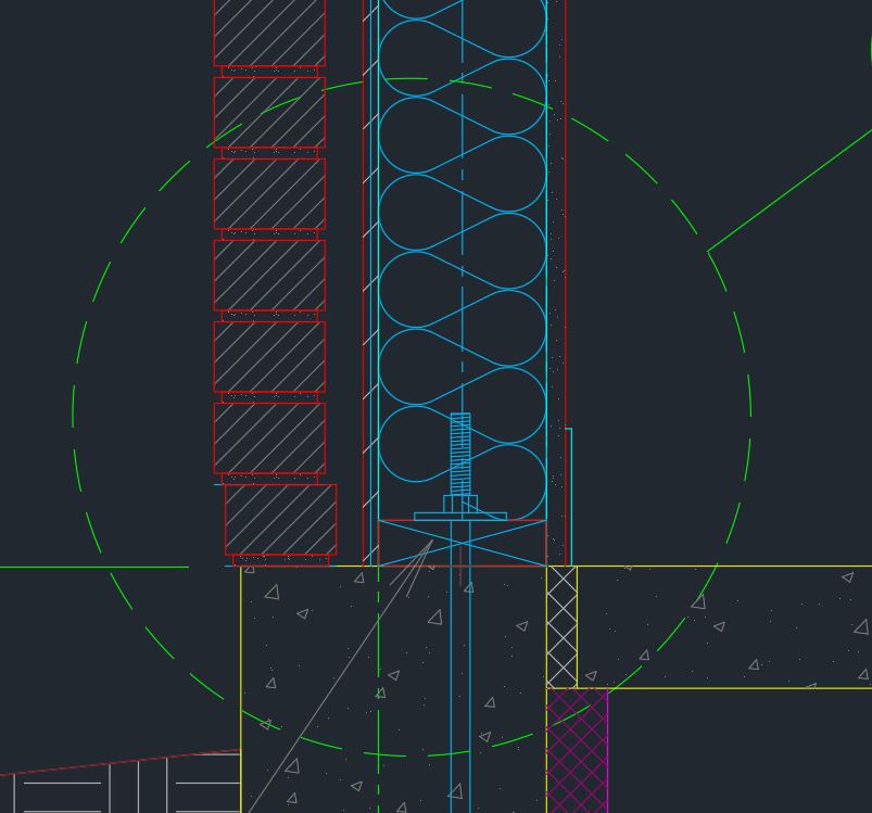

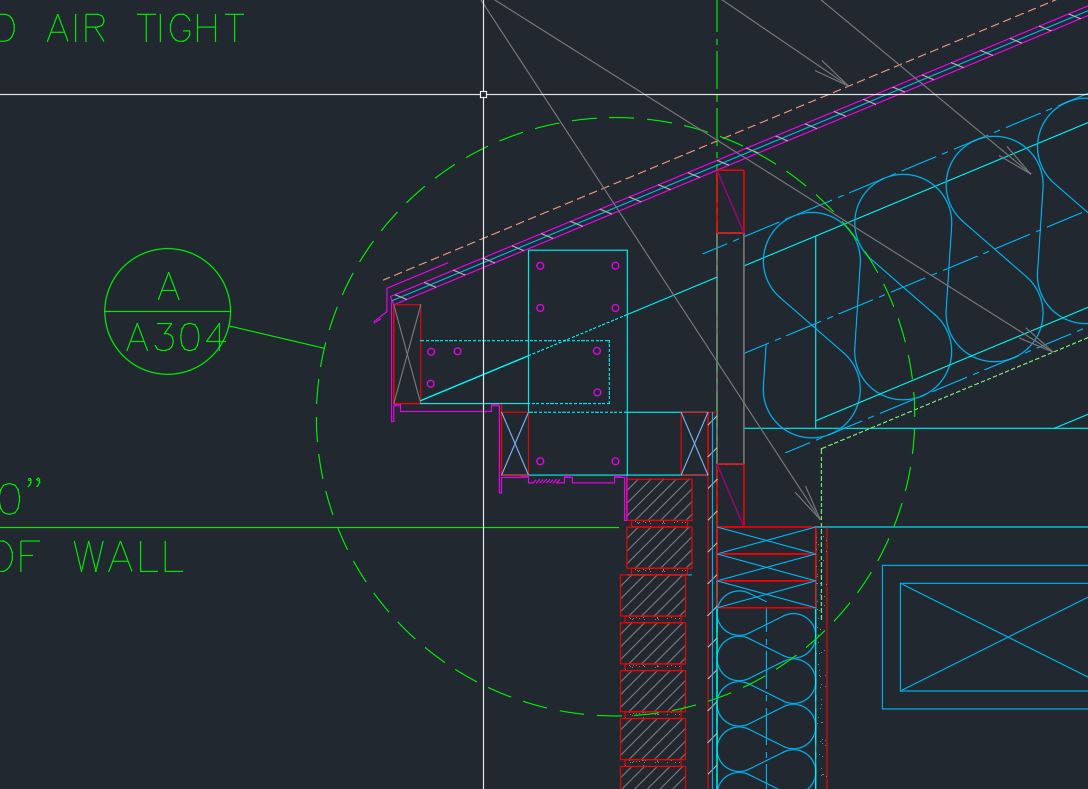

I am working on converting a plan from AutoCAD to Revit and I am at a loss as to how recreate the inset coursing in revit. I have tried several ways but I wanted to see if you all could give me a clue as to how you would do this.
The top (2) courses are inset 3/8", same as the bottom course.
Any help is greatly appricated!

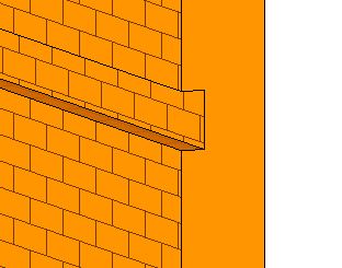

Insert a Wall Reveal (under wall drop down).  Adjust the depth if required.
