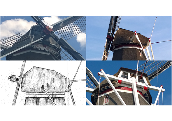

How would you model this thatched roof? I only have an old drawing that is not correct and only gives me a sideview.
Revit 2017

Open a conceptual mass family and create splines that define the various sections through the roof.  Create a form from these.  Once you import this into your model you can assign surfaces to it.
