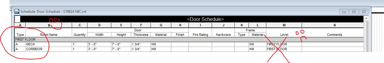

I'd like to sort my door schedule by level and check "header"... however when I do this, it adds a "level" column as well. This is extremely redundent imo. Is there a way to take the "level" column out of the schedule without loosing the sort by level and header? See attached image.

In the Formatting part of your door schedule you have the option of making 'Level' a hidden field.

Perfect! Thank you Smile
