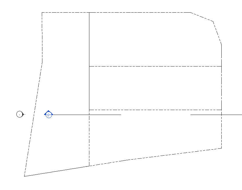

hi guys, im trying to do a subdivision and show the followin pic as 1 complete site with 4 sites within it. revit wont let me make it as 1 set of boundary line sketches, so i have done 4 sites and moved them next to each other but the dashed lines are overlapping and doesnt look good. what is the correct way to do this? i want 1 site not 4 seperate ones.

IF you break the site on the left where it joins the 3 sites on the right with 3 line segments instead of one full length segment - then the boundary lines will sit on top of each other perfectly, and will not appear as a continuous line.
OR
you could simply 'hide element in view' of the 'long' common boundary on the site on the left, will also solve the problem.
