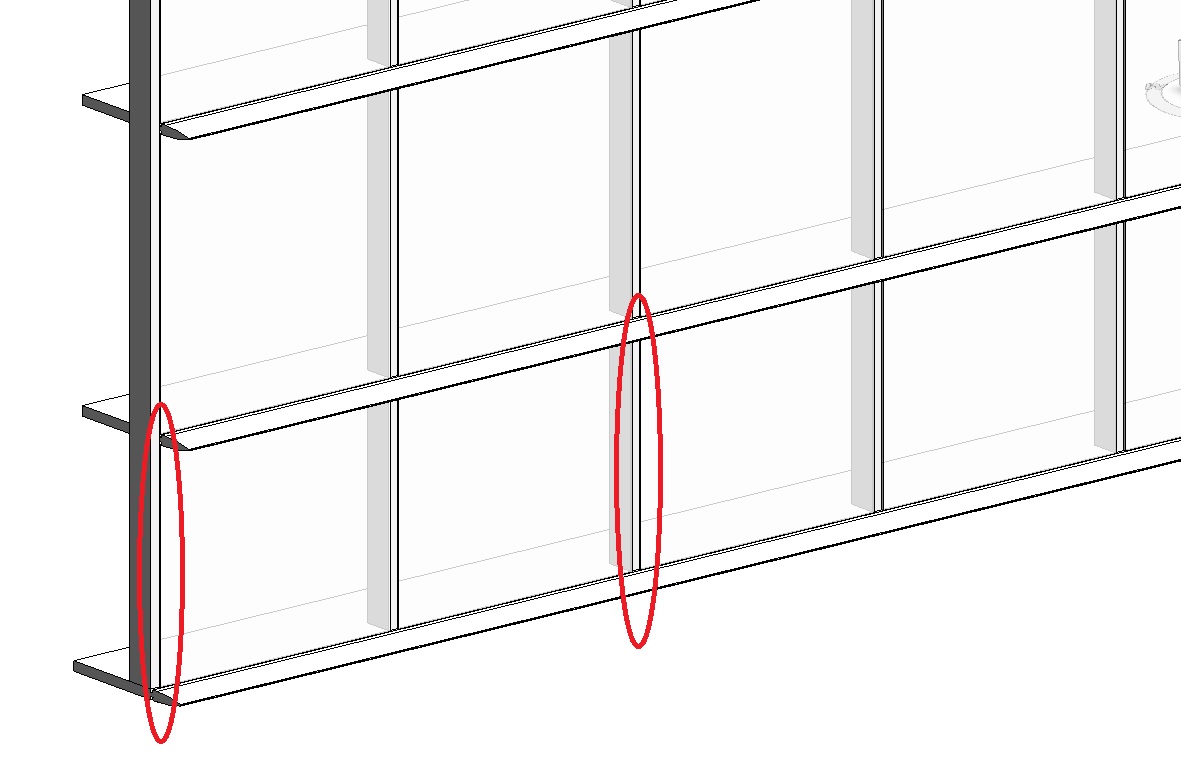

Hi all,
Pls see attached image. I have a curtain-wall, with glazed panels.
The glazed panels are offset to the outside-face of the vertical mullions; problem is that they automatically terminate where the vertical mullions are situated, leaving a large gap between them.
I cannot find a setting in any of the properties dialogues to extend  (or offset) the vertical edges of the glass panels to make the gap between them smaller (since it should be a flush-glazed system).
Also, the edge-panels need to extend past the vertical mullions to cover them completely.
Has anyone found a way around this?
Thanks in advance!
Revit 2015, btw.

Hi
for the glazed panel did you try to select it (just the glazing only) and edit type, enter offset value, NO? not that one?
for the edge-panels to extend, if i remember it correctly, i made 2 curtain wall type:
one is for glazing system with rectangular mullions and
one is just for the horizontal FINS.
just copy, paste to same location, change type.

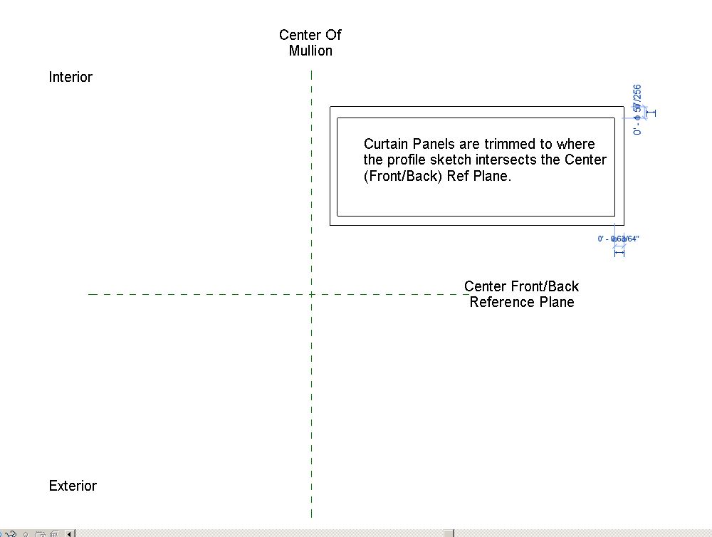

Mon, May 18, 2015 at 7:48:59 AM | Curtain-panels - Need to alter extents
Look at your mullion profile template - the answer is there - I put a box around it.
Tue, Jun 2, 2015 at 8:11:44 AM | Curtain-panels - Need to alter extents
Revin
Joined: Tue, Sep 15, 2009
26 Posts
Fantastic!
Thanks, WWHub.
