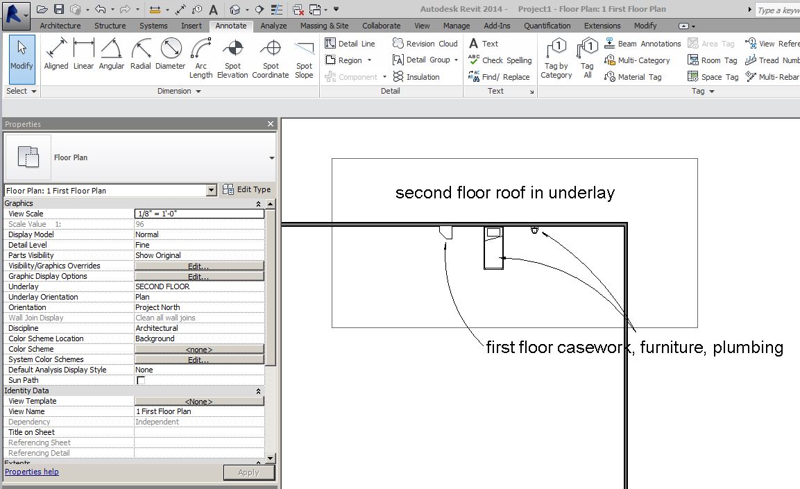

Hi Everyone,
I"m having a really frustrating issue with underlays in Revit.
When I'm in my Ground Floor Plan view and I set my underlay to the First Floor, only 50% of the underlay actually shows up.  Some walls, sinks, cabinets, and other items don't show up.  However, they do appear when I'm zooming in and out of the plan only for the duration of the zoom.  As soon as I stop zooming in or out, certain items disappear again.
What's going on?
Regards.
Wed, Sep 17, 2014 at 7:51:58 AM | Underlay Bug/Glitch when Zooming in and Out
We don't have enough information to help you. An image of the underlay plan pointing out at least one of the objects that don't show, it's properties then an image of your floor plan with it's properties would help.
This could be a graphics card issue.  Turn off hardware acceleration.

Thanks for the reply.  I did a test earlier today with the file and found that if I delete the Roof slab on the First Floor, the underlay works properly.  I'm not entirely sure what the roof slab has to do with underlaying the first floor on the ground floor plan, but apparently they are linked.  I'm now thinking it's a view range issue and the roof slab was causing some sort of weird clash.
Btw, I'm using Revit 2014 and everything is up to date.

I can't recreate your problem.  I even used a plan region in the underlay view so my roof showed and that still didn't hide anything. It must be the components that are hiding for you.
