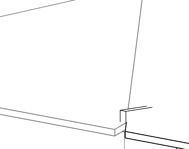

I haven't done this for a long time and can't remember how it's done. I need to bob off the end of a ceiling beam where it projects out of the roof. Thanks

You can use a reference plane the same angle as your roof and trim your beam to that.
