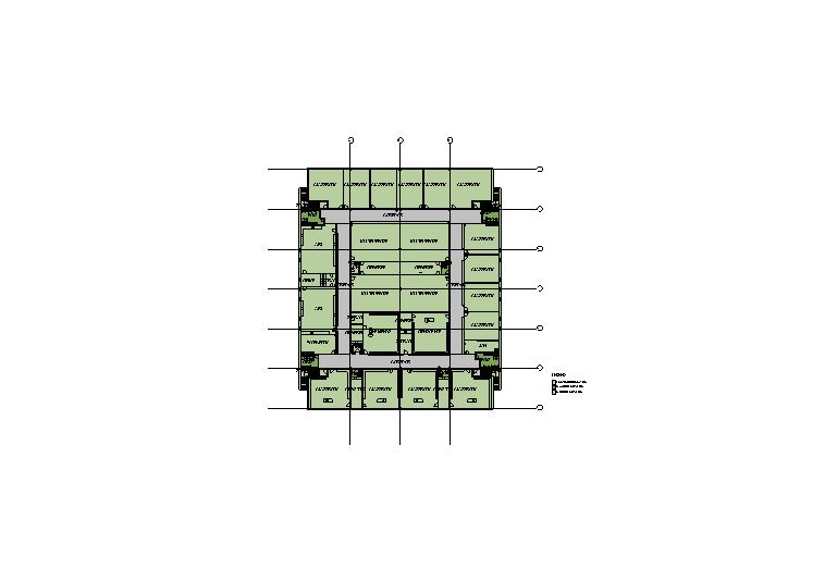

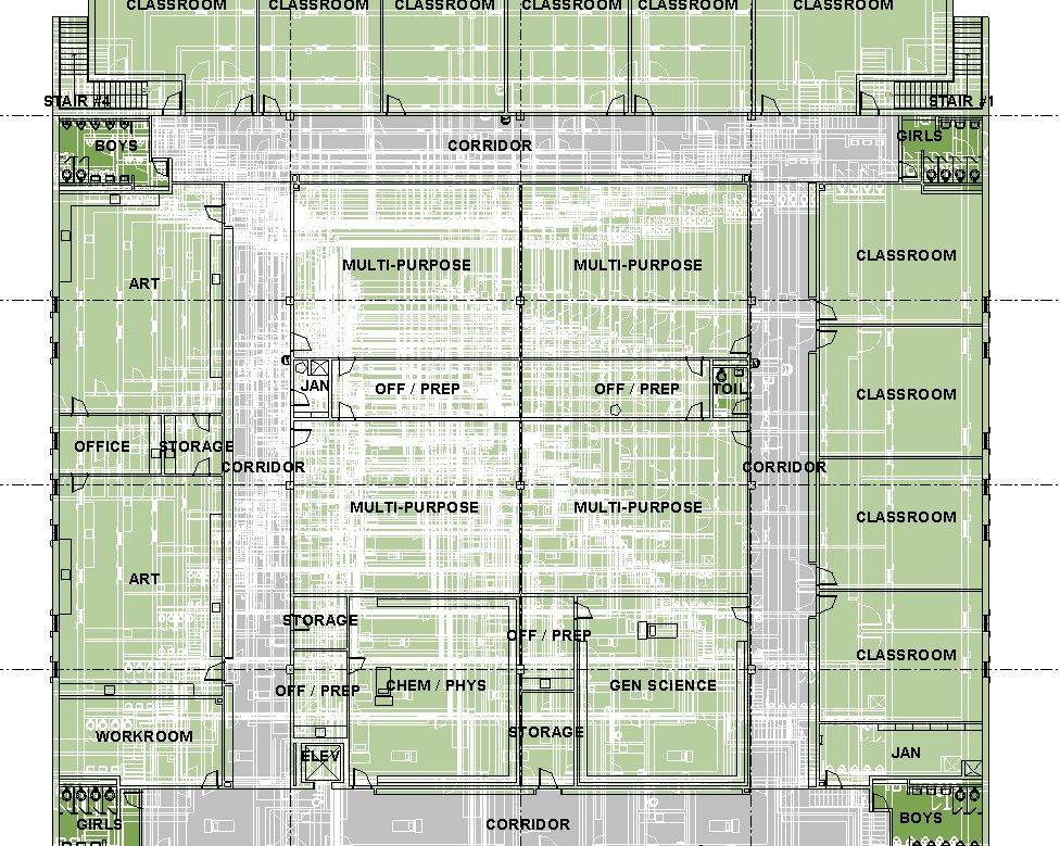

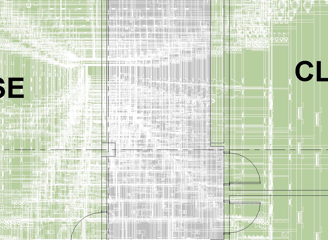

I have a new project we started about three weeks ago. I have to present the schematic plans tomorrow. I recently noticed a graphics issue for any view that has a color filled region or color scheme in an area plan. When you first open the view, all is well. As soon as you start zooming in, you get white artifacts from the model elements (doors, walls, etc.). Please see attached. Any thoughts on a solution?

I have noticed that it only occurs where there are no floors or where the floors are turned off. Once you add the floors or turn the floors on, the issue goes away.

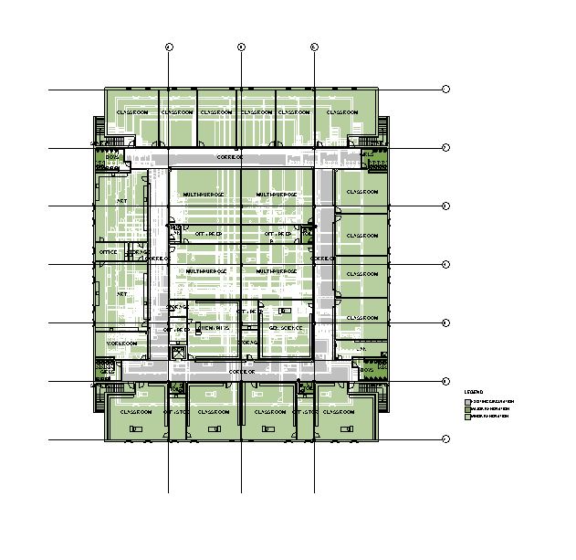

Ahh, the old "glitchy" lines in the background.  This was prevelent in 2013 too.
Let me guess, only one floorplan view is doing this?  Recreate the view when this happens again and delete the one that's glitching out.

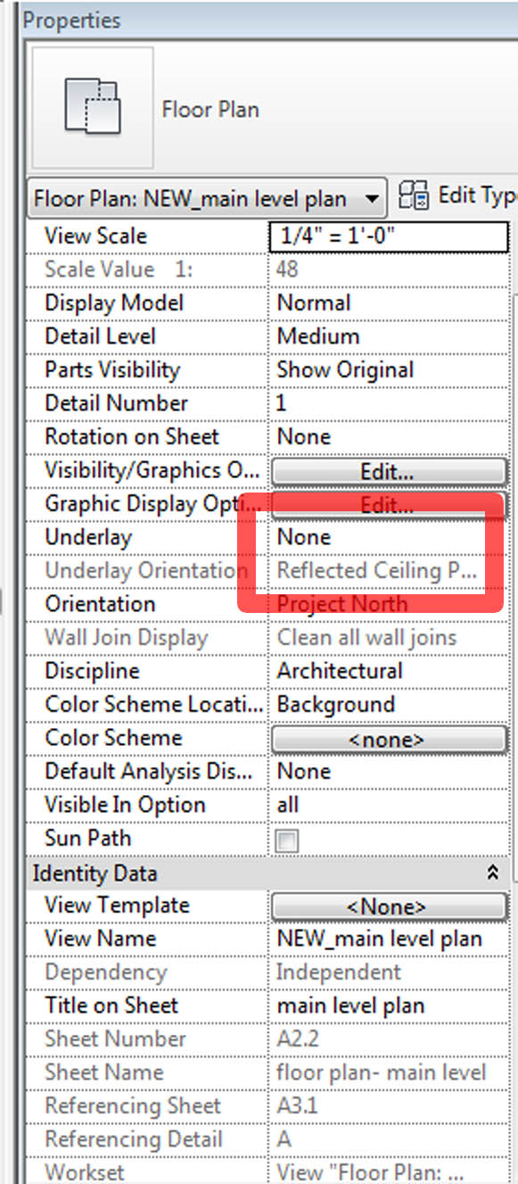

Oh yeah... I've been getting the same "white lines". Something I've noticed is that they're more likely to appear if you have an "underlay" turned on in the problem plan view. Maybe this is your problem... worth toggling your "underlays" off to see if it does anything. I've also discovered that using the translucent override for filled regions also creates these lines sometimes. Found it useful to limit the use of transluscent filled regions unless it's really imprortant. Good luck.  Dan3d
