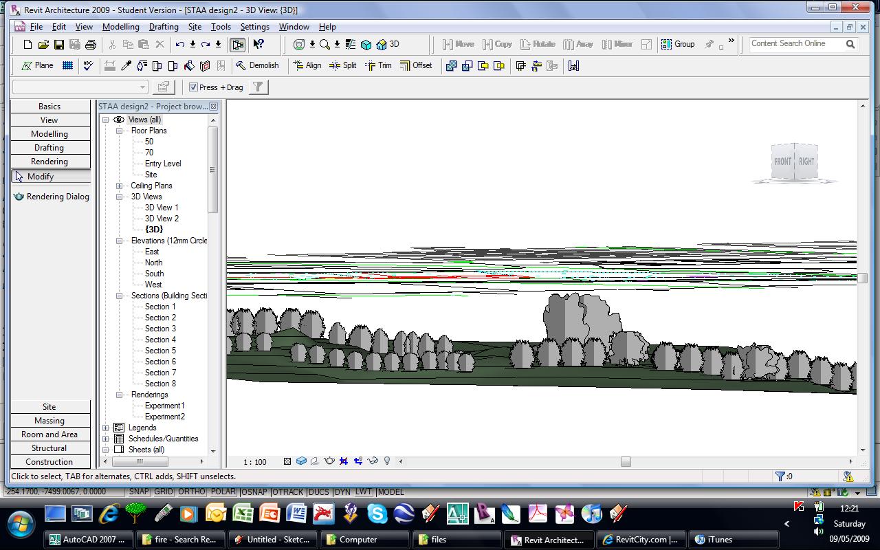

Sat, May 9, 2009 at 6:28:08 AM | Drawing lines on 3D topo
Tim130
Joined: Wed, Apr 29, 2009
15 Posts
I also imported a DWG into revet, this was to use the levels of the site and use the survey features which was contained in the DWG file. I have modeled the site and the trees onto my Revit topography, but would like to know how to 'bind' or 'attach' the dwg lines onto the Revit topo.
The DWG lines are shown to be floating about the topo in the image which I have attached.
Cheers
Tim

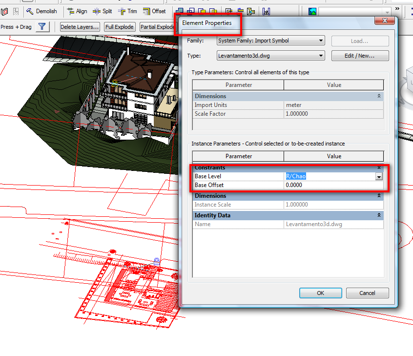

Sat, May 9, 2009 at 7:16:07 AM | Drawing lines on 3D topo
Joined: Tue, May 22, 2007
5921 Posts
4 Stars: 205 Votes
Are your lines in the DWG in 3D??? you can control the level and the offset to position your lines but you CAN'T drapped the lines to the surface like CIVIL 3D does... I don't see any advantage to do that because the CAD file ONLY serve to guide you in your drawing, after that delete them...

Sat, May 9, 2009 at 8:07:15 AM | Drawing lines on 3D topo
tim123
Joined: Tue, Apr 12, 2005
1310 Posts
4 Stars: 19 Votes
You can still use the CAD lines in the plan as information, but there should be no need for this in a 3d view.  You can use the lines as a guide to develop the 3d view as Typhoon suggests to create the different surfaces, such as roads and pavements.
Sat, May 9, 2009 at 8:43:44 AM | Drawing lines on 3D topo
Tim130
15 Posts
Thanks both,
I was interested in having the 2d lins which are from a AutoCad DWG be 'draped' over the 3d revit generated topo. However I understand this cannot be done, and I will continue to trace over the 2d lines onto the topo.
