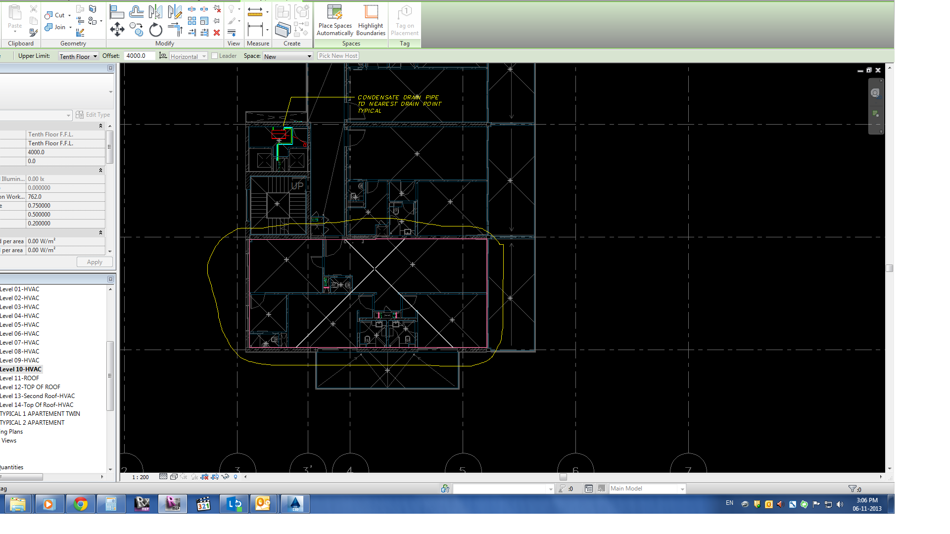

Hi all , I have a problem with revit mep 2012 , when i link Architecture revit file with rooms into revit mep , and started to add spaces , revit doesn't able to do it .NOTE , i checked the room bounding check box at the type properties panel , and when i linked the same Architecture file into new revit mep file , i was able to add spaces !!!
these problem hapened in 2 floors only, not in all floors Can anyone help me please ?

Are the 'spaces' visibility tirned off in the view you are trying to add into ?
Using phases or design options ?

Helps to check the drop down on VG for spaces..you need to have interior and or reference checked
most of my default views have spaces checked but then the drop down only has color fill checked

Thanks dgcad & wgfleth for your response and help, actually i checked the VG for the view for spaces but no matter, also i tried to create view template from the view which i have problem with , then applied these template to another view which has NO problem with spaces but doesn't made any difference.
the major problem is all ather views doesn't has this spaces problem, i tried to copy monitor the concrete level for the same floor ( 100 mm below the original floor '' Finish Floor Level '' ) but the problem didn't happened again the spaces is normal.

Here is a snap shot for the problem , Revit can't dedict the room correctly.
