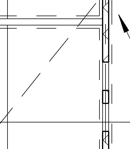

hello - i am working on a foundation plan and need to have my footings appear with dashed lines. when i change the line type in visibility graphics, my foundation walls become dashed as well, which i do not want. is there a way to have the foundation walls appear with solid lines and the footings below to appear with dashed lines? thanks!

Yes, pick on 'linework' icon, select line you want and pick on line which you want to change

thanks - my view range is set up exactly as you say kb, but the footing lines remained solid...xane's method worked out great for now.
