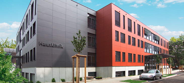

Hi everyone.
I'm currently using a curtain wall split into a series of panels to represent my ACM panels.  Each one is a different color and can be scheduled perfectly.  My problem however is that when I render my project, the lines between the panels do not appear; the colors and materials just end and begin with no apparent joint or separation between them.
Can someone suggest a solution?

I would like to achieve an effect like the one in the attached image.

Use a mullion.

use a thin mullion
