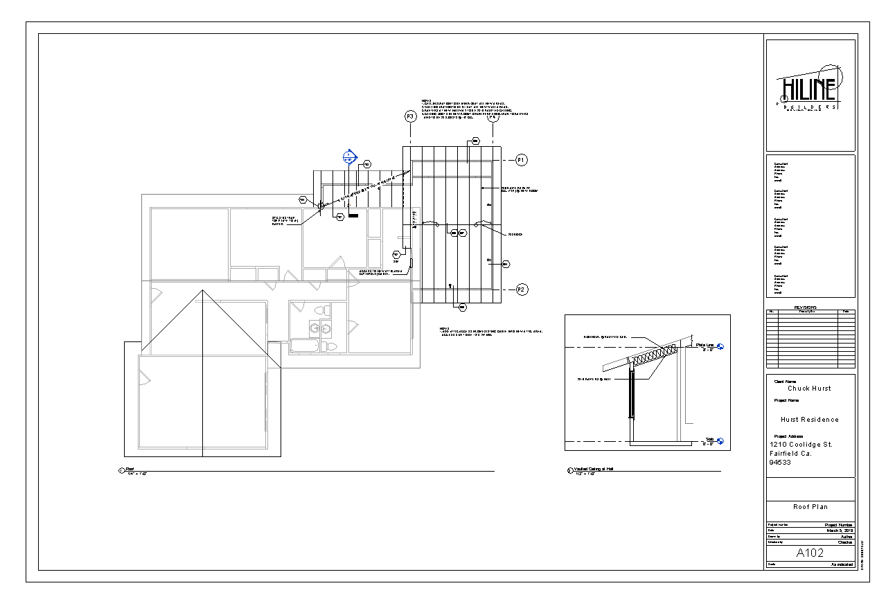

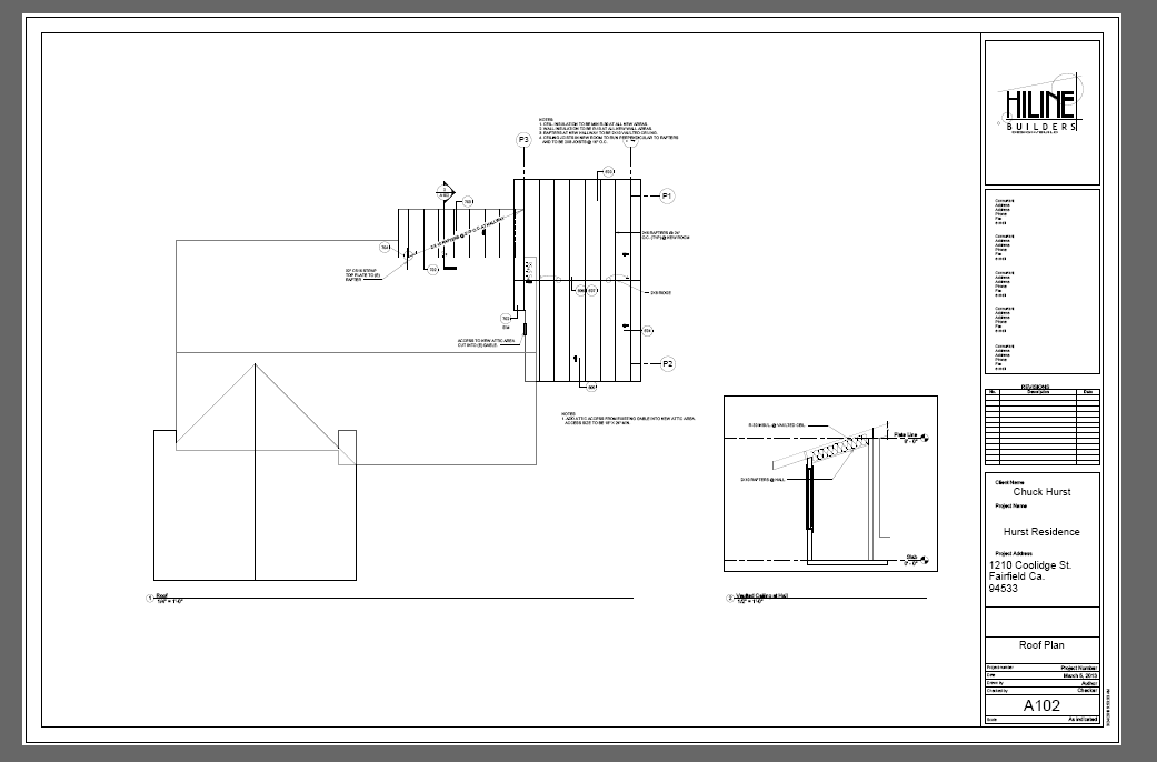

Can anyone tell me why my existing walls show up fine in my sheet but don't plot to .pdf

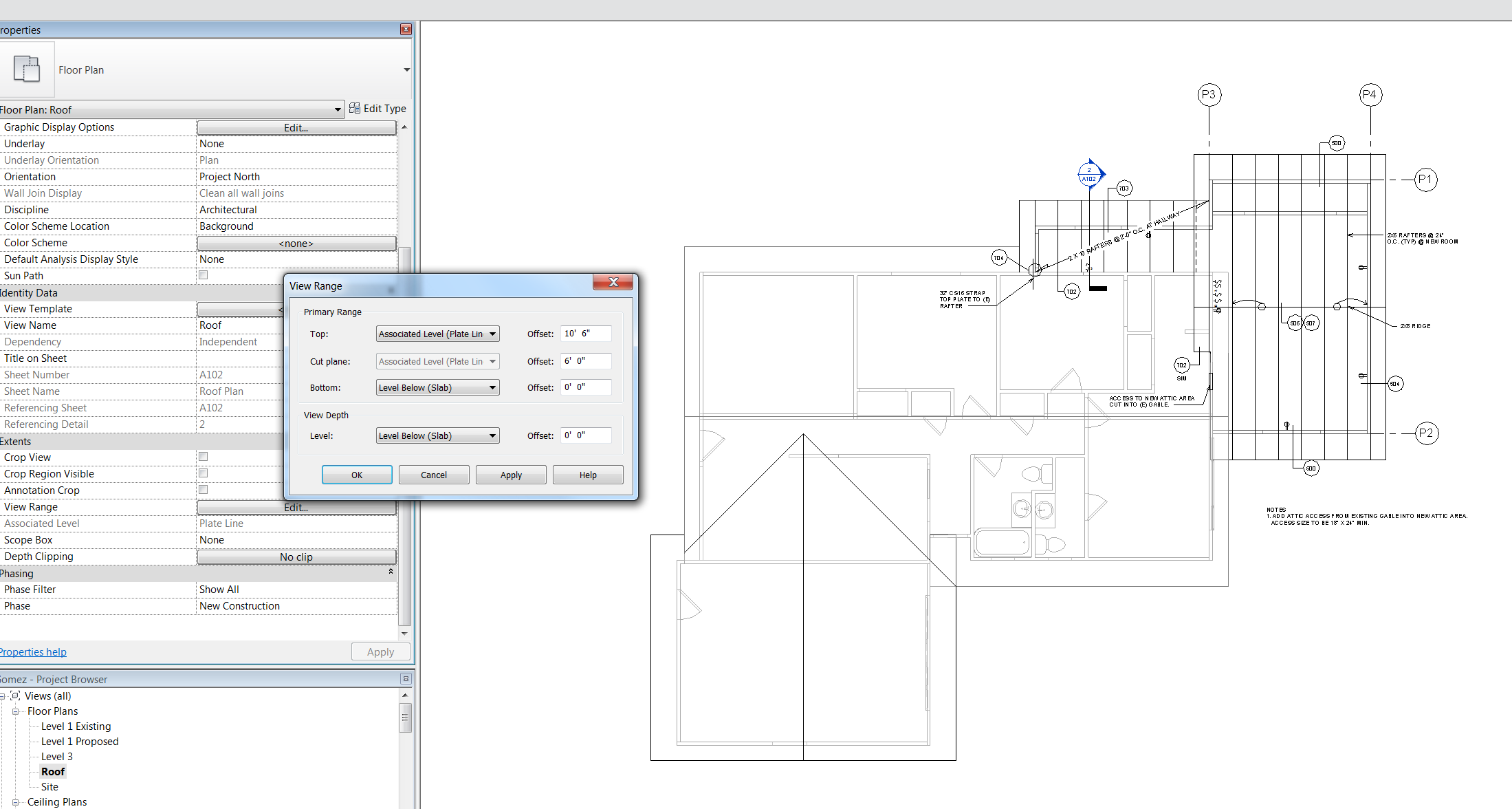

I have the view range settings set correctly and all other sheets plot fine.
I thought maybe the roof transparency was the issue but
Revit is usually pretty much a WYSIWYG plotting operation and the walls are displaying in the sheet file.
Not sure what I'm missing here.
I'm in 2013.
Please see attached files.
Thank You.

If that is an underlay, do you have your halftone set too low to print?

Underlay is set to none. view range is set to slab. It should print as it shows on the screen and it's not.
I did however get a reply in another forum to try plotting at Raster setup instead of vector and I did, and it worked.
I still consider that a workaround since it should plot as displayed anyway.
All other sheetgs plot fine. I thought the roof transparency needed to be adjusted but that wasn't the case either.
