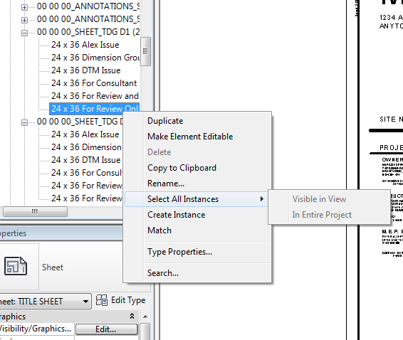

I have 2 types that I want to delete from my title block family. I have no instances in the project and I still can't delete
them from the project browser? Anyone have trouble with this or know how to delete? I've attached a screenshot.

Nevermind. I just had to delete the family from the project browser and reload with the deleted types.
Thu, Feb 28, 2013 at 9:34:03 AM | How to delete Title Blocks
You can delete the type as well from the browser and also when you purge unused.
