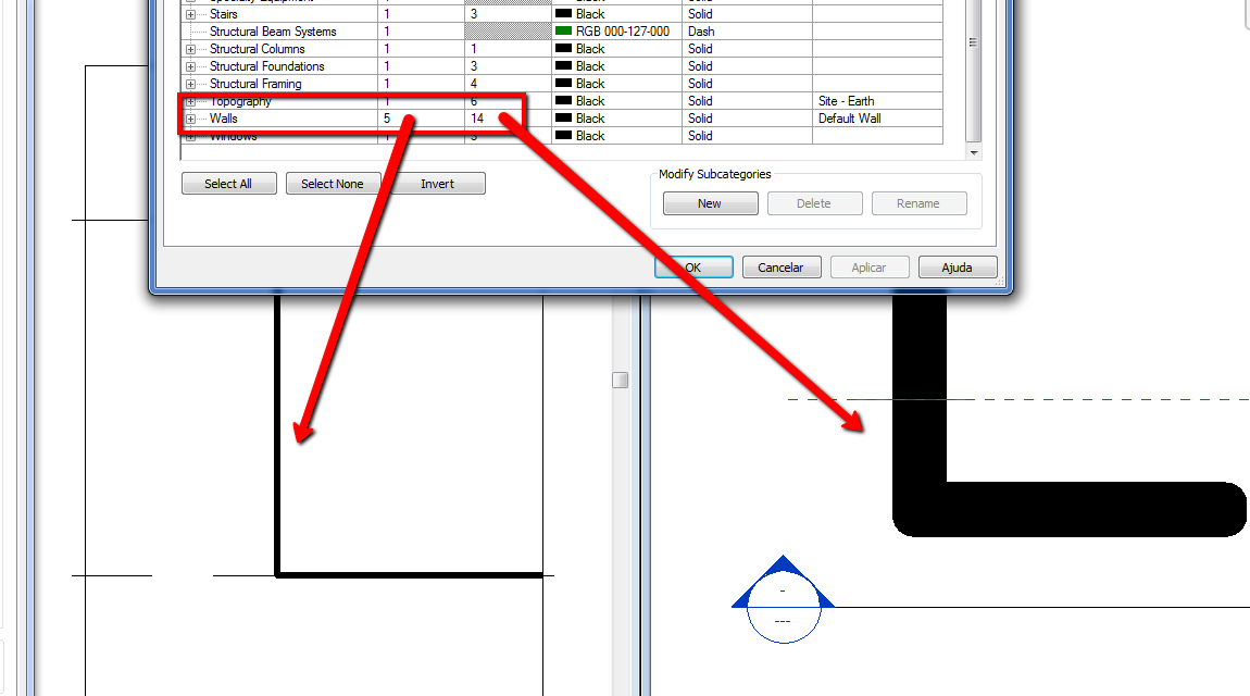

I am just new to Revit so Please can any one tell me in Objects Styles Menu there is Line Weight and in This there is Projection and CUT what are These.
Thanks
Sat, Nov 24, 2012 at 5:06:59 AM | Projection and CUT
Joined: Tue, May 22, 2007
5921 Posts
4 Stars: 205 Votes

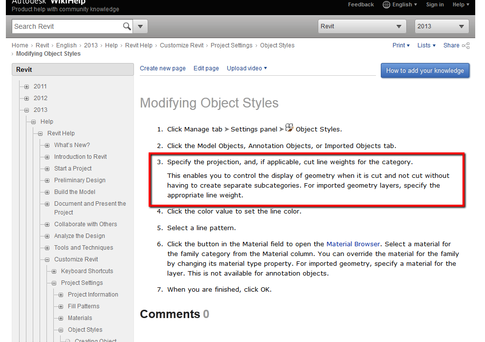

"Projection" = when you are not cutting the object.
"Cut" = When you are cutting the object.
