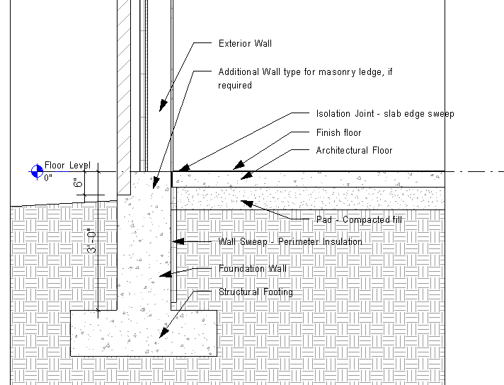

How to modify the cut pattern (ex.inside the wall)

I don't know if I understand the question right,
if you want to show the materials in the plans- just show -you can simply ues for the Detail  level : Medium or fine ( the button is near the scale button or in the properties
if you want to spearate : you can click  the button create parts by selecting the wall... it will apear in the modify tab... then all parts of the wall (block-paint ... will be modified  because it is separated.

Mark, I don't understand your issue... You want your walls in plan view like you have i(n your screen shot) in section view?
What do you mean by: " I know only the default but I can't modify." ?
I don't get it...

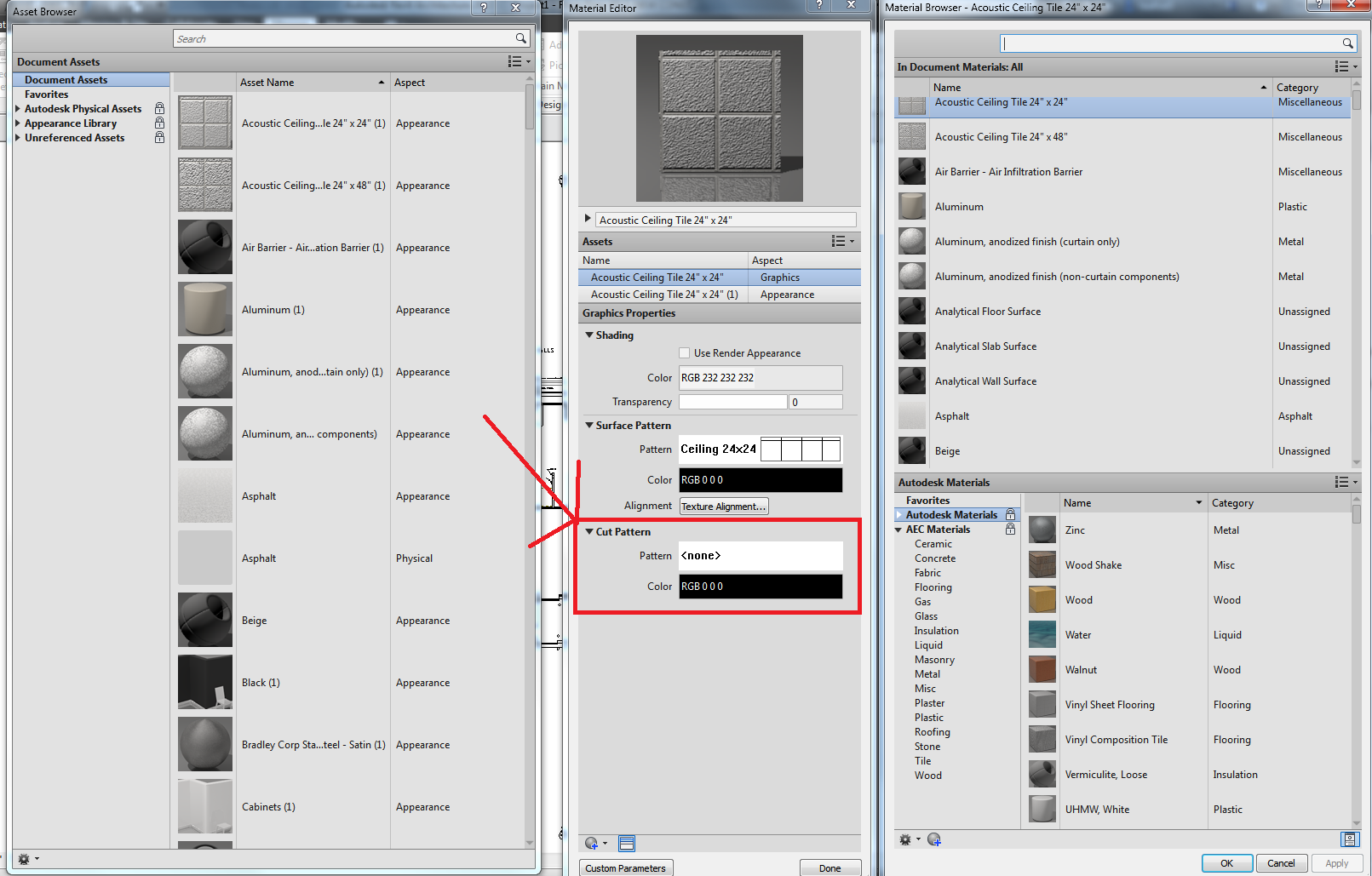

The cut pattern is in the materials editor. See attached pic.  Just change it from "none" to a pattern you want.

Guys Thanks for the reply.My problem is,how to create a new cut pattern?is thier away?
-we have a lot of cut pattern for the wall right but I want to create my own design for the cut pattern if thier is a way. Thanks

ahhhh... you want to create PATTERNS....
here: http://www.revitcity.com/forums.php?action=viewthread&thread_id=8590
another one: http://www.revitcity.com/forums.php?action=viewthread&thread_id=21478
