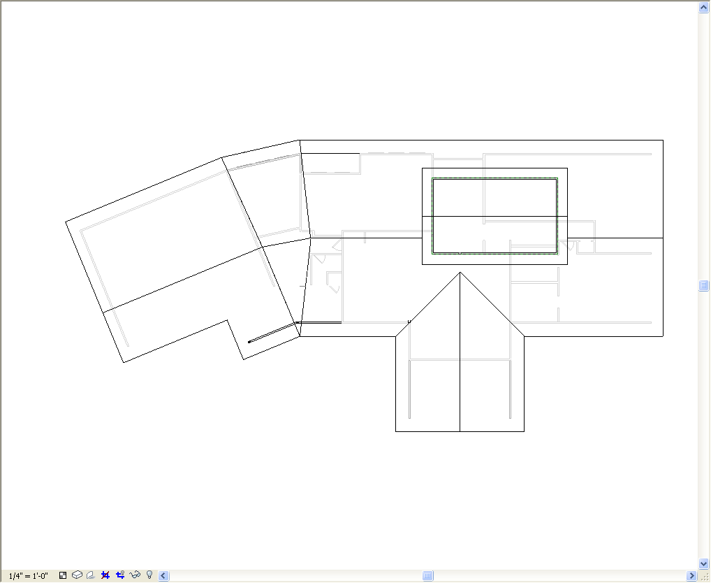

Can't seem to recall the workaround for this, (see attachment). When I attach any walls to the roof, they no longer show in the roof plan. As you can see in the attachment, several perimeter walls seem to be missing. How do I fix??
Thanks,
Phil
Sat, May 26, 2012 at 11:07:20 AM | Walls disappear in roof plan after attaching to roof.
This is correct, you have a roof plan.  Walls that are below the roof and are attached to it are at the bottom of the roof.  Unless you make the roof transparent, you will not see them.
You could have the roof plan with the level below as an underlay.
You could use the level below and underlay your roof then add overhead lines.

make it wire frame view. then use the detail lines to outline your walls below the roof. then turn off wire frame. the lines can be locked to the walls. do this at the end when your working on graphics and presentation.
