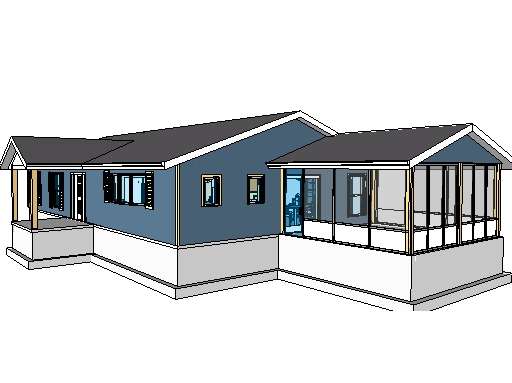

i was worndeing if howtocrayea sreen in revit for a proch

Just use the wall tool, using an appropriate material setting. Or same material using the massing tools if you're concerned about wall scheduling in the future. Either way is easy.

Personally i'd either use a railing or a curtain wall to achieve this.

In answer to your question regarding the material used for the screen, I suggest you take my tutorial about transparency mapping. http://www.revitcity.com/tutorials/transparency_mapping/tutorial.php

Make it as big as it needs to be. If it needs to attach to things or will vary in height use a curtain wall...

Certainly can. They just work differently you have to swap the panel out for a specially created curtain wall door or swap out a panel for a wall then place a normal door... Do a search on some of the curtain wall threads, they should give you a good idea.

Here's a screened porch I've been designing. I used a Screen pattern material file I found on revitcity...same with the 3-tab shingle pattern on the roof in this view. I used a curtain wall, solid & screened panels, a door is placed in the wall (still designing the door family from the mfr catalog). As was previously stated I adjusted the transparency setting so we can view thru the screen and also conduct sun/shadow studies with some tree options also contained in a Revit design options. In Elevation Views, the screen is not transparent (acts like window glass in elevation) Actually, I have 3 Revit design options for this space...one is this screen option vs a full insulated wall vs completely open but covered patio space. Cheers. Revit Blog: www.taylor-tech.com/danielhughes

The best solution imho is like Mr spot said, use railing! easy to use, you can define and change profiles and heights. you can still insert a door, just create a clear wall insert the door and set the lenght of the door to the opening size, you won't see it. OR, if you feel like trying something a little harder, try Mr. Spot tutorial about nested array families. you can create a fully parametric screen family. Smile

thanks, i used Mr. Spots idea of using railings. and im having trouble downloading pattern
