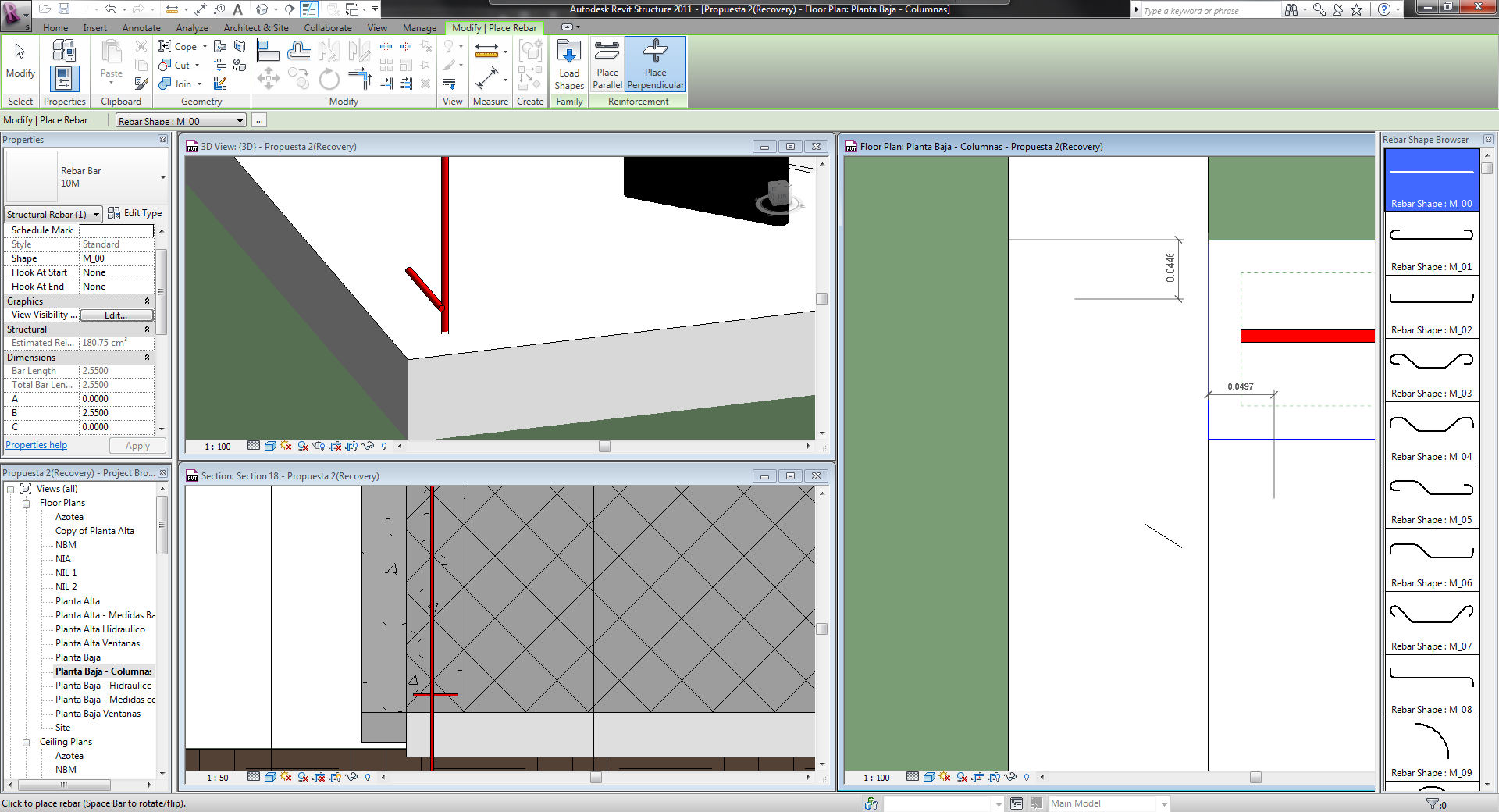

hi, so i am working on structure and something is going on with vertical (perpendicular on floor plan) rebar that are not being displayed on the floor plan. it doesnt say it cant add it, i just cant see it when adding and once its added
on the screen shot i have the 3d view to show they are near and not maybe on a different place,
on the section that is going exactle across the column i am able to add and view at the same time any type of rebar without problems
and there is also the floor plan where i can only see the parallel but not the perpendicular one
hope i was able to explain this correctly and really really need help.
thanks in advance

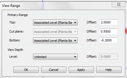

view range on floor plan

Select the rebar and check the "View Visibility States" in the properties box.
Thu, Apr 26, 2012 at 9:58:11 AM | unable to view vertical rebar
emorocks
Joined: Sat, Sep 20, 2008
42 Posts
still the same, i unchecked and checked back again the view unobscured option and still the same
