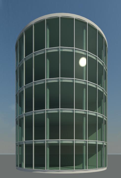

3 - MOST IMPORTANTLY!!! creating the external finish to look like glass like the attached file.

3.  As for the  materials, it is as simple as applying the right material (glass) to the wall.  I would imagine you used a curtain wall, in which case it should be glass already adn you can adjust the transparency and properties in the materials dialog.
