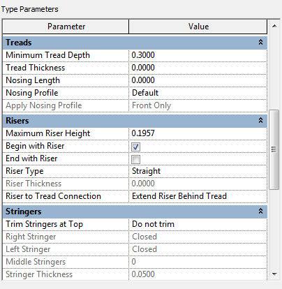

hi, i am trying to create the attached stairs, but when click on finish it says it cannot create monolithic stairs
i want it to be .1957 the riser hight since its the current hight of the actual construction but it is setting up different and want to have 14 instead of 15

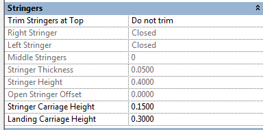

i have attached the settings also
so basically i want to have 14 stairs to go from level 0.35 to level 3.09
i hope i explain it well, i am having lots of trouble with this

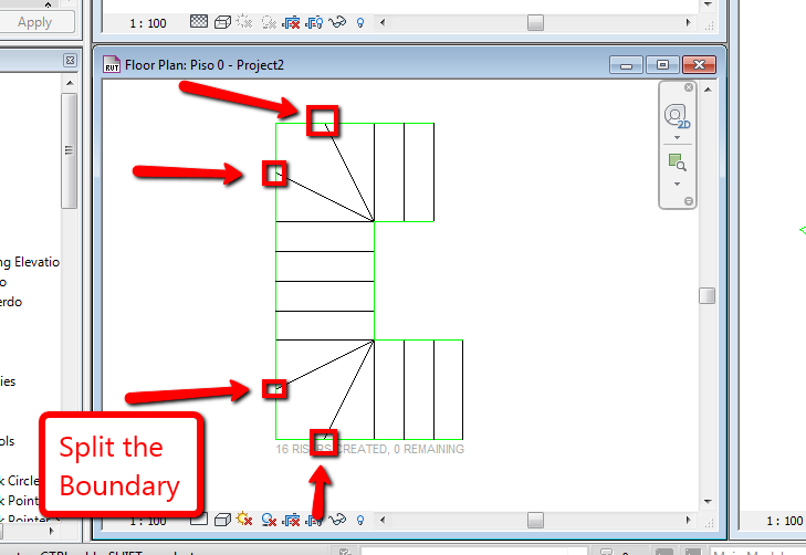

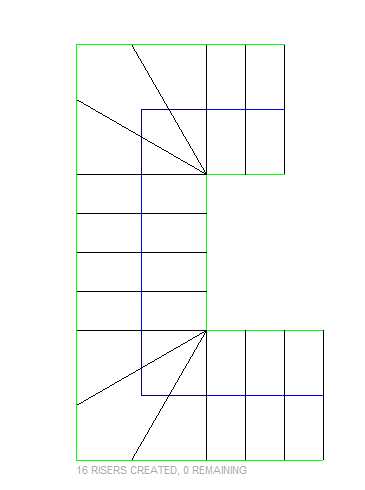

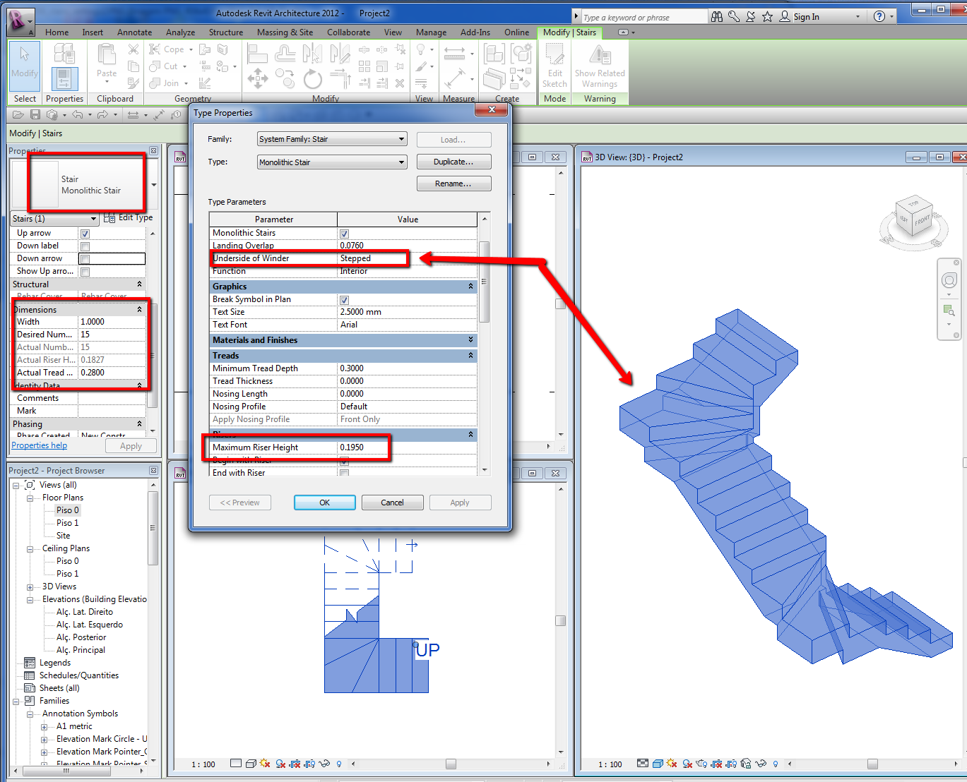

Change the "Underside of Winder" to "Stepped" and split the Boundary...

amazing! works perfectly! thanks a lot!

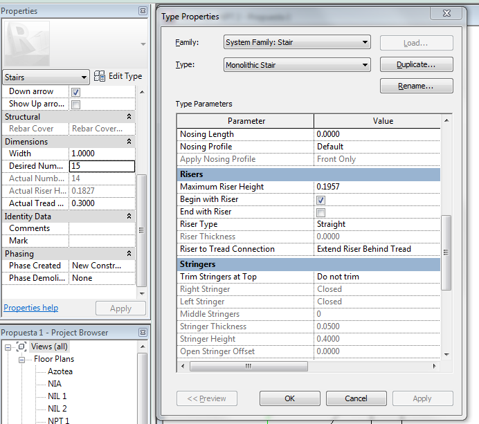

hi, hope is not too late, but i didnt notice that it still ask me for 15 risers instead of 14 as the current house has.
the actual rise is .1827 and on the properties i type .1957 for the maximum height, how can i make it be that size so i can have only 14 risers
thanks again!

i just got it, sorry, i changed the max height to .20 instead of the exact amount which was of .1957
