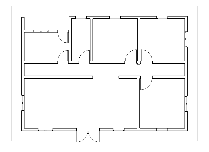

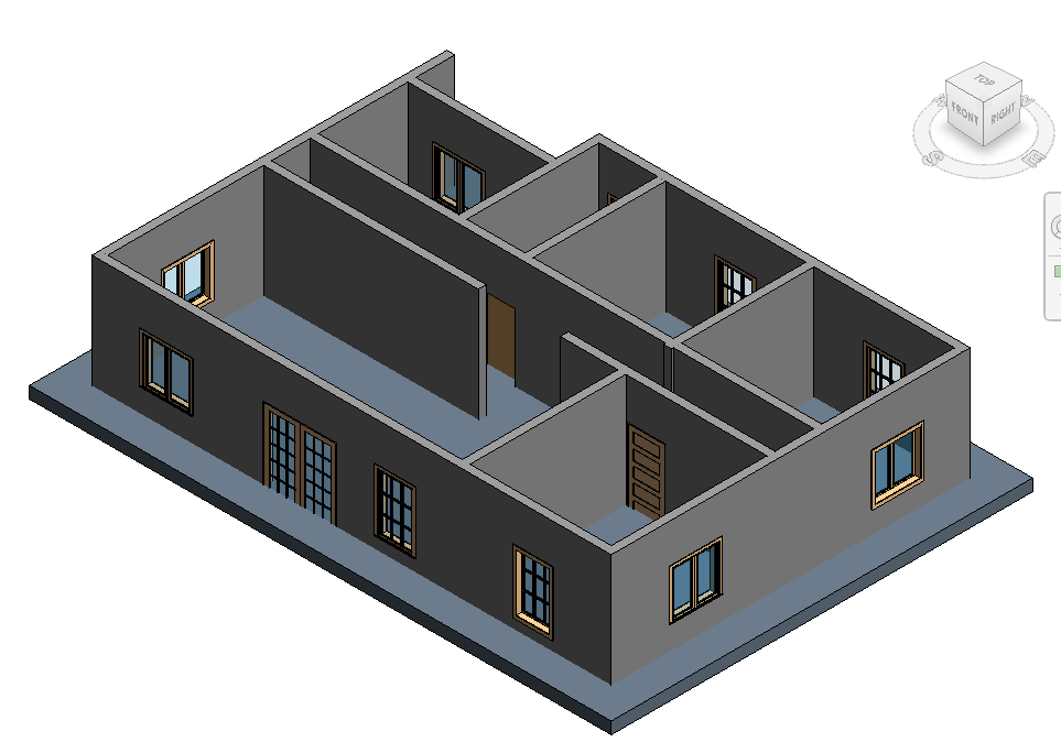

hello am new to revit. when i use the command roof on my plan it does not appear i can only see the rectangle the roof command created when i used the pick wall command and on 3d it appears as a slab .really need help. thanks in advance

It would appear that your roof has been created on the floor level.  Move it to the next level so that it is at the correct height.  Your roof appears as a slab because it has no slope.  Edit the boundary and set the lines for sloped roofs to 'define slope'.  There is a tick box to define the slope when you select one of the boundary lines.
