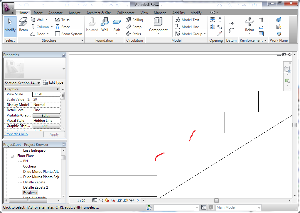

i have a doubt, i am doing a monolitical stair and will like to know if there is an option to have it with a fillet arc on each tread?
i think i kind of explain it on the attached image

it doesnt has to be an arc it can be a line on 45°

yeah i tried that but i need to have a cut out on that corner of 45°, the nose will come out the thread

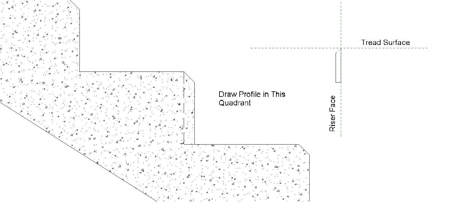

try making a profile similar to the attached. This nosing is kept within your tread dimension.

nice! thanks!
