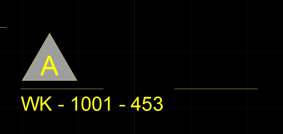

See attached images.The first image shows our  company's standard section-head (drawn in AutoCAD).

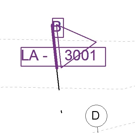

I've created the section-head in Revit, along with two labels; one being the section-number inside the triangle; and the other being the drawing-sheet the section appears on,(aligned to the section-line). The second images displays the revit-drawn section-head.

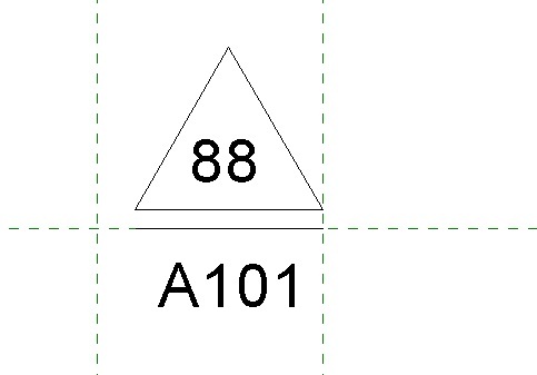

The third image shows how the section-head is displayed after being loaded into the Revit-project. The section-number text needs to be fixed inside the trianlge (but kept readable ; ie. horisontal); and the drawing-sheet number label-text needs to be aligned & locked to the angle of the section-line. I cannot find any way of doing this (ie. locking a text to a point, or locking it to a fixed position in relation to a line with a changeable angle). No matter what I do, each time the section-line is at a different-angle, the label-texts are only shown in fixed relation to the original section-head start-point.

I've tried both. Doesn't make any difference. The text / label remains the same.
Somehow there has to be a parameter to rotate the text/label to remain aligned to a line...

Your only options are as described here: http://docs.autodesk.com/subscription/REVIT/2011/ENU/filesUsersGuide/WS46b90c3cb2c58cadb753f8fc7f98a3be-7f81.htm
Wish we could say more.

Thanks, WWHub. I guess there's no quick-fix for this one, then. Cheerio.
