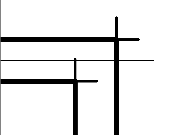

hi
is there any way i can have thinner lines at the en of the walls?
i have attached an example of what I need for my proyect
the middle line is just a grid
i am using revit arch 2011

You will have to add these somehow if you really need them.

yes. for this urgency i had to create pair of lines with a 90° angle and put them on a group and went corner by corner with a copy paste
anyways i which there was some feature like this since i like how it looks, its like back in the days when layouts where made by hand

You would be better off using a family instead of a group.  Groups tend to slow down the model.  I would make it be 2D linework - in a wall hosted family.  After placing on the one wall face, you can align the other face.  These lines would then turn on / off with the wall and would move with it.
