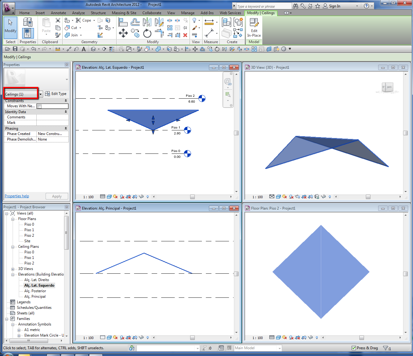

Like this?
"Create In-Place" in Ceilings category

Almost.  But I also want this ceiling to slope upward, toward a peak on the right hand side.  is that possible?  I tried to rotate the sloped ceilings, but Revit doesn't let me do that.

Or maybe this is it, but I don't really understand how you did that.  I've only been using this program for a couple of months, so still learning.

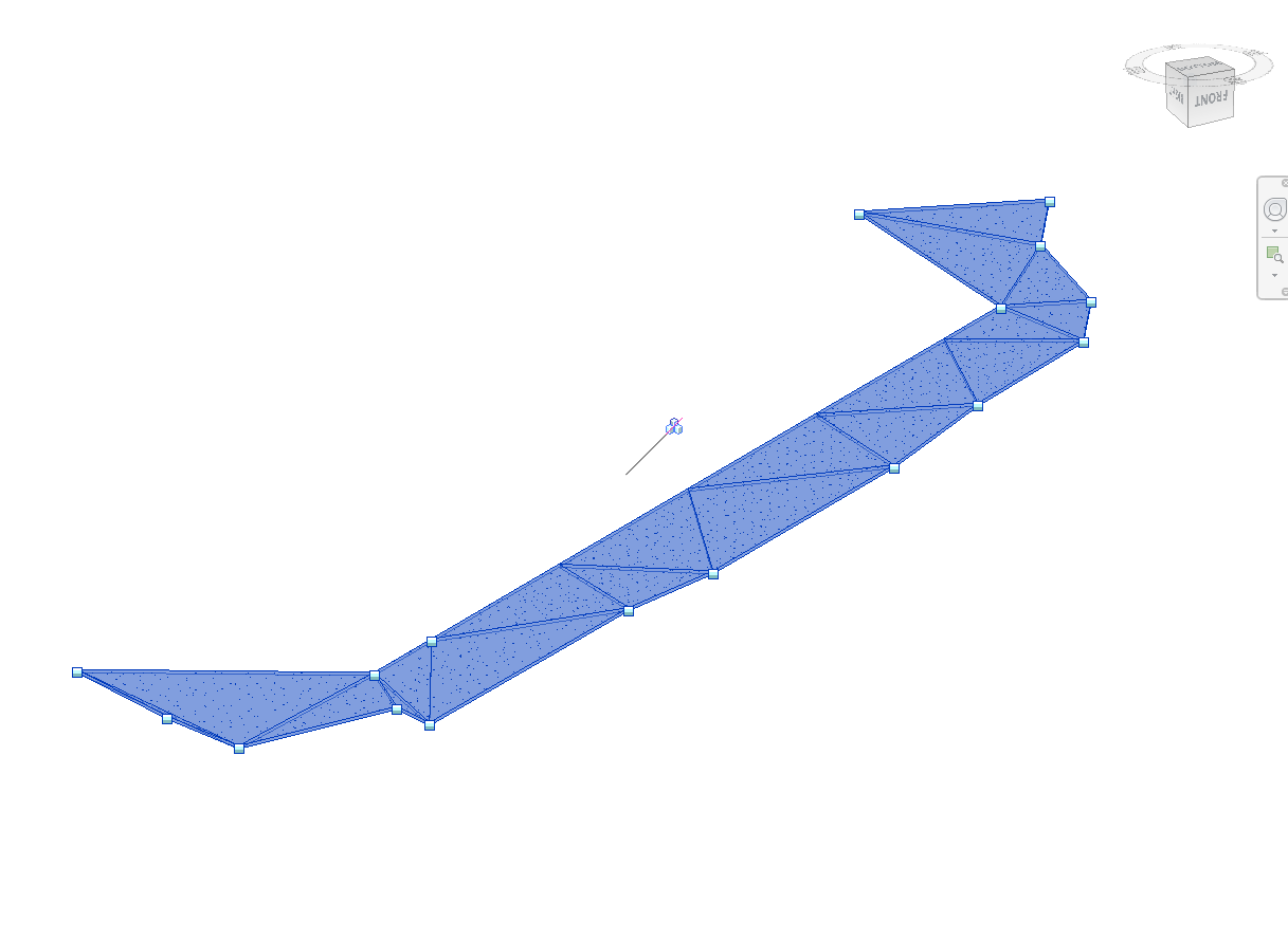

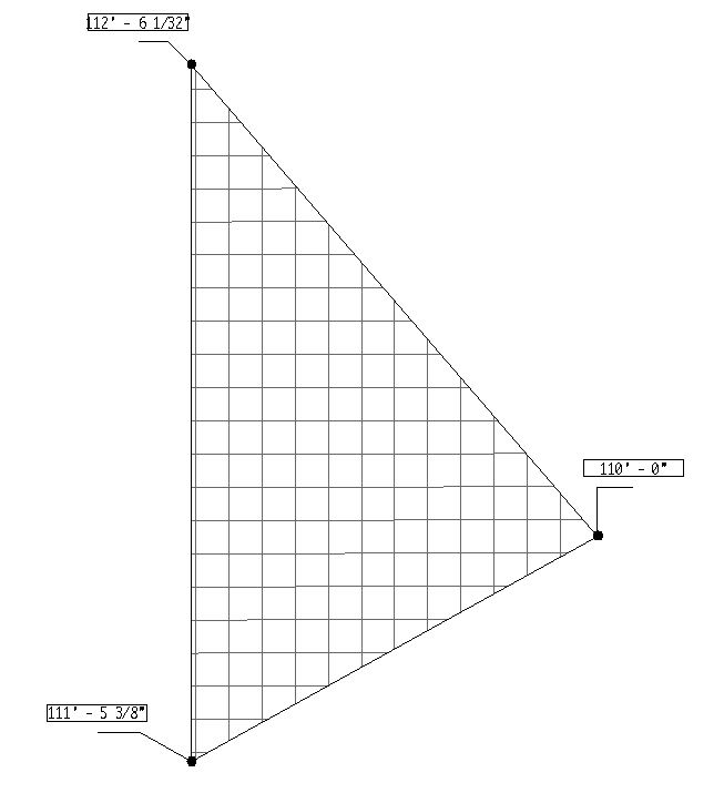

I have a similar dilemma and I'm trying to avoid using any in-place or alternate objects to acheive two slopes in a faceted ceiling. In what way can I use a slope line such that I can have three precise height offset points? In my case I have the offset points that I want annotated with the third point (not annotated) being at the level of the ceiling. Does anyone have a good procedure for this? I should I use something that is not a ceiling object?

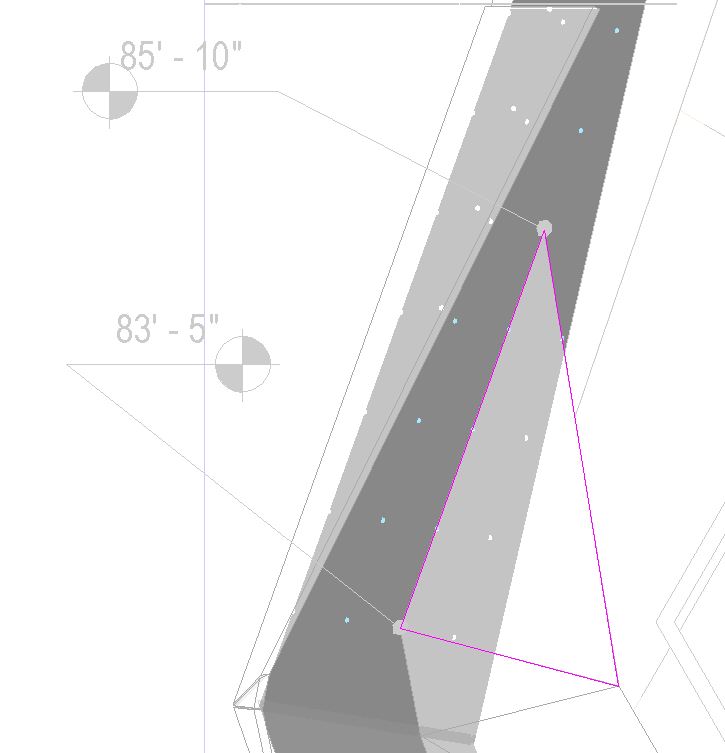

Thu, Jan 23, 2014 at 7:24:37 AM | Sloped Ceilings
#9
teafoe5
teafoe5 Avatar
Joined: Fri, Nov 12, 2010
1749 Posts
4 Stars: 47 Votes
Its possible but you will have to play with the slope arrow angle and elevation (at head in my pic) to get the numbers you are looking for.  In my opinion an in-place component would be easier if it is just this one ceiling area.

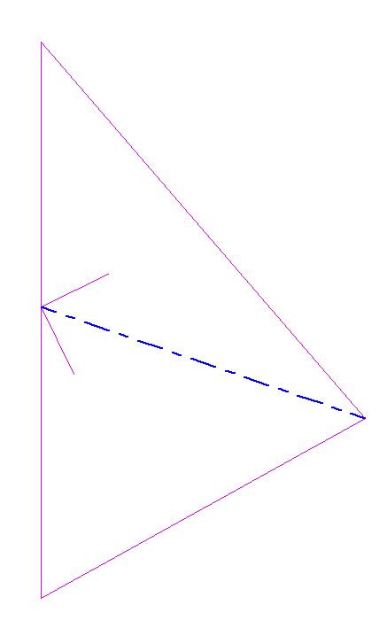

I've tried this similary to how WWHub has posted: completing the quadface of the triangle and extending the arrow along the diagonal, but the points do not match what I need. If I can't do the geometric derivation I would have to do a formula. In the end I'm leaning away from this method and will probably build my ceiling as a floor object instead, but I wanted to excercise this method to illustrate this issue. Thanks for your response!

It's definitely an outside of the box method, but luckily those issues don't really apply too much to RCPs since seeing or not seeing a floor is not a problem. Scheduling, I could see in specific instances that it could be an issue, but from a material and assembly standpoint it's no different. The limitation is that Revit ceiling objects fall short if you need non-regular geometry that slopes in two directions with specific endpoints. Building individual sketch ceilings with slope lines or in-place components do not suffice because making changes becomes a hassle. Maybe Autodesk will give more options to ceiling objects in the future, but in the meantime, this method appears to provide the best and most accurate result with minimal tradeoffs. Of course we shall see. If anyone else has had success in similar cases let me know!
