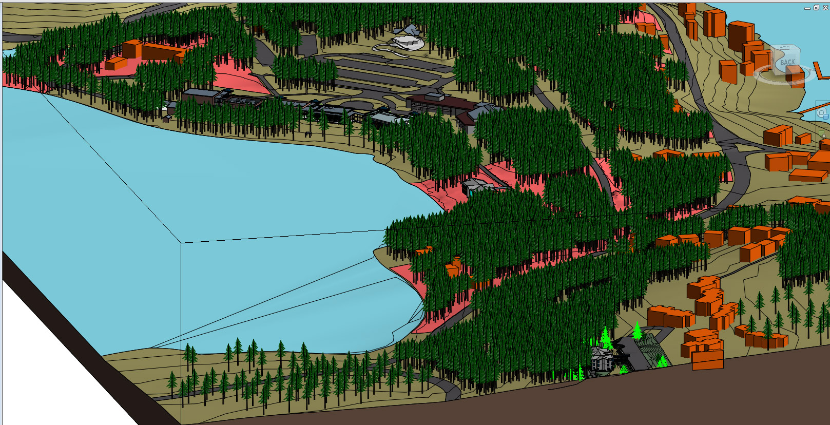

We use a lot of sub-regions in our projects.  They can really bog down the topo however, if you site is measured in miles.
Here's something I took to the extreme which I don't exactly recommend....  Since we have 4 projects within a couple miles of each other, we decided to roughly model several square miles of town, and link in our project files on top.  It might develop well, but the trees are obviously a little off the hook, and making any changes to topo or trees take a couple minutes.  All of the asphalt is one extraordinarily complex sub-region.
So any time there is a change in the topo or anything affecting topo, revit is forced to rethink the sub-region properties/area/whatever at the same time.  It's the #1 contributor to sitework slowdown, as I learned by deleting it and trying the same tasks.

@itmyalterego - That site plan looks pretty mental... Subregions are obviously pretty limited in terms of doing up a detailed site plan, I've used them before and it wasnt fun... those giant sub-regions are really unmanageable. Im sure I saw someone map a 2D image onto a 3D topography in 3DS max years ago... I dont have or know how to use 3DS max though unfortunately, so I can't really confirm that. I've seen tutorials where google earth topographies are brought into sketch-up with both the topo and the surface image being retained, so maybe there's something along those lines that could be done.

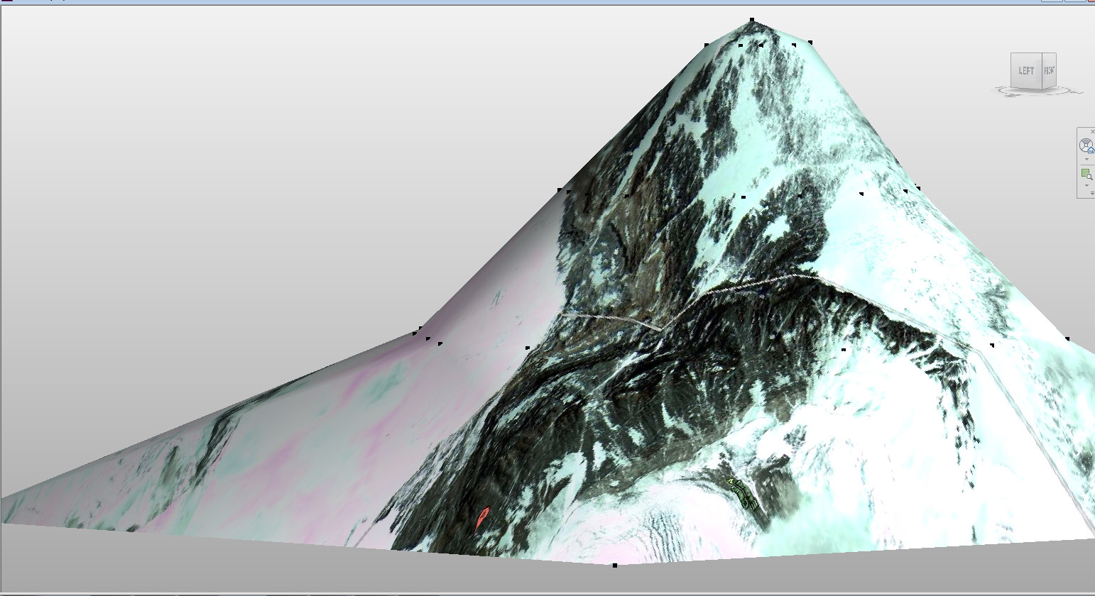

But for images, that's not really an option.... UNLESS...  Hmm.  I just had a good idea.  You make your site plan/Aerial image jpg at a 1:1 scale.  You can then assign this as a material, and give the material tile size the same dimensions as your jpg, and then apply that material to your topo surface.  I will upload an example in 10 minutes.

BEHOLD!
"Reverest"
 Obviously you don't have to be extreme and the gradient will cause a lot less distortion on any real site plan/building site.  But that's a principle someone could try exploring further if they have some ambition.

Looks promising... That's the render appearance that you used right? I don't have much experience with that, but I know you can't put a hatch pattern on topo (that would have been the handy way to do it probably). I assume it's not going to be so easy to position it correctly, but I'll see...

correct -- that's the "realistic" view in 2011.  Or for renderings.  In other views you would have to rely on imported images.
Also, positioning could be difficult without a hatch to rotate it with.  you might have to tweak the rotation on the material to get it right if you go this route.

itsmyalterego - that material was an interesting suggestion.  I'm going to have to play with that to see if we can use it....
