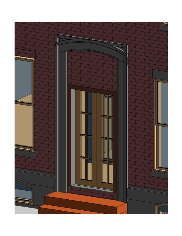

I am working on modelling an existing brownstone which has alot of ornate trims and cornice details. At the entry on the exterior brick, their is a masonry trim around the opening. There are quite a few profile intersections and curves/arches. I can model this in sketch up or rhino very easily as a mass but once i bring this mass into revit and give a material property to the mass, revit gets angry. I translate the mass object by providing a material for each face. In this case, i created a 3/4" concrete basic wall to replace the mass object.
Is there a better way of modelling complicated shapes and then using them in revit? Do you need to give an imported mass a material or can it stay generic? I didnt think wall sweeps would work because of their are varying intersections and profile shapes.
Any help would be great.

You should be able to model anything like this in Revit if you try,
You really should model these as either an in-place or external family.  ... And no need to do a mass.  All these shapes are the same so why not model it as what it is instead of as a mass?  A cone is a cone ... a sphere is a sphere...why use a mass?
Post a picture of what you are doing and we can give better suggestions.

Here you can see the trim around the exterior opening of the door. The top with the arch seems tricky. Also, i attached the digital version created so far. Thanks again for the help and suggestions.

That casework is easliy done in Revit using sweeps.  I would do it as a family... face based.

ok, i will give it a shot...thank you for the suggestion

a couple of things i would like to point out:
1.  If you are modeling linear pieces along the facade wall, you can accomplish this with wall sweeps built-into the wall families.
2.  If you are modeling the same moulding around multiple openings (i.e. all windows have moulding types a or b) you can incorporate this into the window families.  A quick note about the window families- if they are existing openings, you don't need to make them paramteric.  Sure, it's nice, but in terms of modeling effort (I assume your family-editing experience is not high) then it is a much more simple solution to the actual modeling effort.
