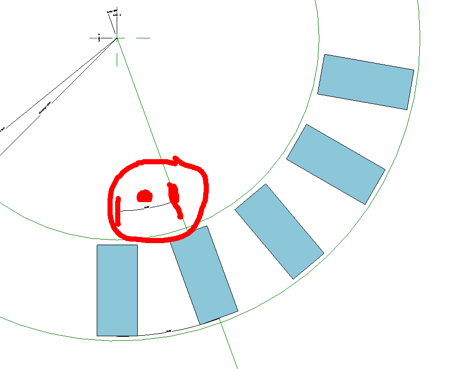

Hello
I want to make a curved parkinglot with
a - a radial I can change parametrical
b - the size of the parking and also the inbetween dimension
c - the number of the parkings
The problem starts when I constrain the array to the corner of the second parking.
When I then change the corner the family's constrains are not longer satisfied.
I tried it with a angular parameter and a forcing of the refline with dimentions.
Is this possible or is there a total different way to do this?
Kind regards
Ron Wubbena

Parametric radial arrays in Revit have not been so helpful in the past.  I tried to create a similar family (different purpose) in release 2009, but could find no way of controling the radial array.
You may have to nest one family (the radial array family) inside another (the container family which controls rotation.)  I haven't tried it (just thought of it) but it might work.

The parking is a nested family.

why not just make one side of the parking stall lines and then array that.
