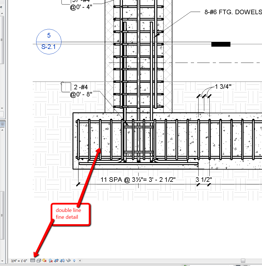

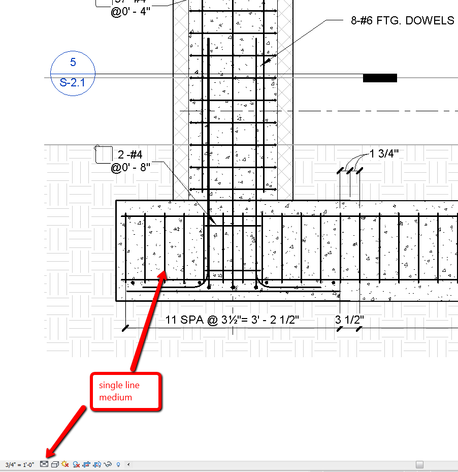

I have been using RST for all of my projects since R4 and most of them are concrete. Out of the box it has always been single line for coarse and medium and double line for fine. It must be a program setting because when I open a 2011 project with 2012, it changes all of my single line medium details to double line.  See the attached details in RST-2011.  The only difference between them is the detail level.  I could supply thousands of examples from past projects.

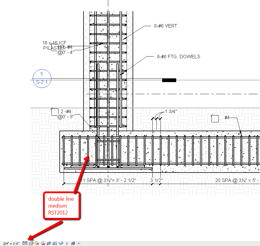

It works fine for me in RST 2011 as well.  It is 2012 that is broke.  Here is the same detail I showed earlier in RST2012.  This is medium detail.  The only thing I did was to open the file in 2012.  This really screws up my older projects.  The rebar at 3/4":1'-0" is too busy for double line but you lose all of the structural steel beams and columns if you use coarse detail.
